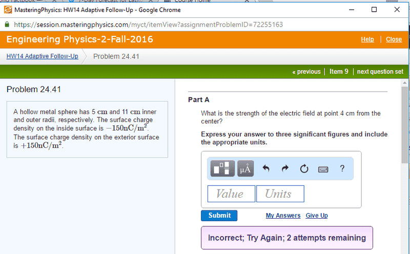

What is the Electric Field inside this charged sphere?
k_squared
62
Let me just put this here:
http://i.imgur.com/dgcWAC3.png
Screenshot of a MasteringPhysics problem 24.41 about a hollow metal sphere with 5 cm inner and 11 cm outer radii, with surface charge densities of -150nC/m^2 and +150nC/m^2, asking for the electric field at 4 cm from the center; an answer box shows an Incorrect message with 2 attempts remaining.
E_flux=EA=(q_encl)/(permittivity)
Area=4pir^2
Whenever I manipulate the above equations, I get a term of the form R/r, which implies, R being 5 cm, and r being the radius inside. This implies that the field goes to infinity at the center, when I'm pretty sure by spherical symmetry it is 0!
Not sure how you'd get an expression with R = 5 cm, when evaluating the field at r = 4 cm. Using Gauss' law at r = 4 cm gives you the field at that point, assuming spherical symmetry. What's the enclosed charge at that radius?
That's true and Gauss' law agrees.
