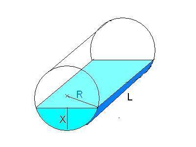

Good day all,
someone gave me this problem to try to figure out (for fun) and I'm having a bit of a hard time:
A closed cylinder of radius R and length L is filled with liquid. The volume of the liquid is equal to 1/3 the total volume of the cylinder. If the cylinder is layed flat (horizontal - long ways), how high up the sides does the liquid go?
The answer involves an inverse trig function. The answer is not in terms of elementary functions - find an approximate solution graphically. Well,
I I am not sure my approach is correct, but I tried integrating "slices of water" from y= -R up to X - with X being the height of water along the side in terms of R (i think the bounds on my integral are wrong).
I ended up with :
[tex]\frac{13\pi }{12}= \frac{x\sqrt{R^{2}+x^{2}}}{2R^{2}}+sin^{-1}(\frac{x}{R})(\frac{1}{2})[/tex]
...which seems horribly wrong. Any help on how to approach this problem?
Thanks!

The volume of the water in the " horizontal" cylinder is that of a cylinder of length L but with base a segment of the circle of height X. No need to integral.The area of the segment is area of sector - area of triangle.

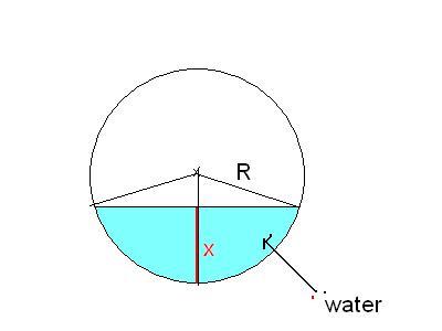

The area of the sector is ##R^2\theta / 2##. The area of the triangle is ##R^2\sin(\theta/2)cos(\theta/2)=R^2sin(\theta)/2##. The area of the segment is the difference ##0.5R^2(\theta-sin(\theta))##.
And ##X=R(1-\sin(\theta/2))##.

You get rid of theta if you solve the equation volume of segment-based cylinder = 1/3 volume of cylinder.
Expressed with theta, this means
[tex]0.5R^2L(\theta-sin(\theta))=LR^2\pi/3[/tex]
simplified: [tex]\theta-sin(\theta)=2\pi/3[/tex] The approximate solution is about 2.6. And X=R(1-cos(theta/2)). (My previous X was wrong)

theta=2.6 radian.
Are you sure your x is what you think is?

Note that X = R (1-cos(theta/2)) I made a mistake in that post.
