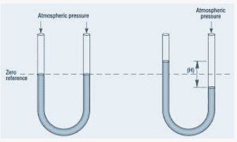

Instead of guessing the necessary pressure, run a test. Play a harmonica by blowing through a piece of tubing. Put a Tee fitting in the tubing and connect to a water manometer. Measure the pressure needed to play the harmonica in inches (or cm) of water. No need to convert to PSI. Then connect the fish tank compressor to the water manometer (without the harmonica). If the fish tank compressor will produce enough pressure without the harmonica, but the pressure drops too low when the harmonica is connected, then the fish tank compressor has enough pressure, but not enough flow. In that case, get a larger fish tank compressor or add a second one in parallel.
Water manometers are an excellent way to measure pressure. Cheap, easy to use, never need calibration, and 100% accurate.
