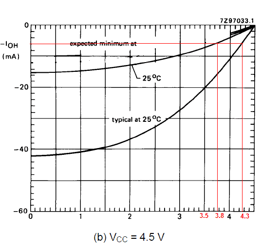

Assuming the output voltage from the ic is 5V which I used to calculate my base resistance. The current would be about 5.5mA
No worries here the gate will survive this.
As we can see from this characteristic
The voltage drop across the gate output will not be larger than 0.8V and typically it will be around 0.3V.
Thanks, So I can assume the output voltage from the gate and hence the voltage to the base of my transistor will be about 4.7V ?
Yes.
