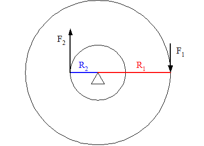

You apply a force of 17 N to a wheel with a radius of 0.75 m. If the axle has a radius of 6 cm, what is the output force, assuming the machine operates under ideal conditions?
I don't even know how to begin to begin this. Help!

I'm thinking it has something to do with Idea Mechanical Advantage which is output/input I believe.

You can think of the setup like a lever, with each arm being a radius and the fulcrum being the shared center of rotation (axis). Surely you've covered simple machines like levers?
Sort of. Would output force be F2?

Sure. For a lever, which end is "input" and which is "output" is your choice based on the situation at hand. Base your choice on the scenario presented in the problem statement.
gneill's picture is probably much better help than anything I could put into words.
