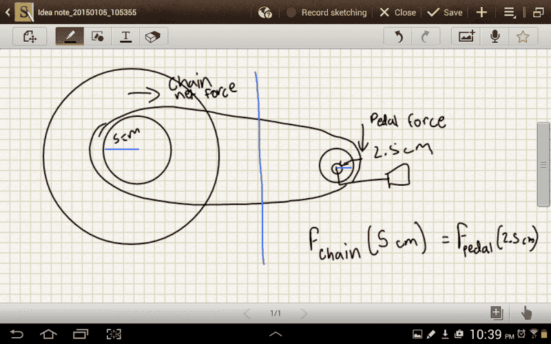

I am kind of confused. My understanding was that the pedal sprocket applies a force to the chain and that same force is transmitted to the rear gear. Doing a moment balance would mean that the force transmitted to the read gear would be less the force applied on the chain. Why should the torques equal?
I did do a FBD like you said though. Is this correct?
The torques are not equal.
I did do a FBD like you said though. Is this correct?View attachment 86916
Your FBD is correct except for one thing. You omitted the torque applied to the rear wheel by the ground.
Now that you've drawn this free body diagram, you need to split it in half into two separate free body diagrams at the location where you have your vertical split. You then need to do a moment balance about the pedal axle and about the rear wheel axle.
I'm going to do it for the pedal axle, and leave it up to you to do it for the rear wheel axle.

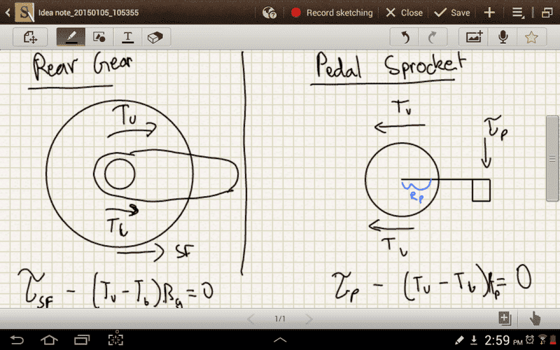

Is this correct? My equation for net torque pertains to the rear gear.
Handwritten sketch on a tablet with two parts: a pedal sprocket diagram labelled Tu, TL and Fpedal, and a rear wheel diagram labelled Rw, Rg, Tu and TL, with the equation SF(Rw) - (Tu + TL)Rg = sum of torques and a Static Friction arrow.
I am not sure if my force diagram is correct for the pedal sprocket. It seems as if Tu, Tl, and the force of the pedal create torques in the same direction.
In what direction does TL pull on the rear sprocket?
You've done the rear wheel correctly, once you correct the error that jbriggs444 pointed out, and you set the right hand side to zero (since we are neglecting the rotational inertia of the rear wheel). The moment balance I wrote down for the pedal was correct. So the next step is to combine these two moment balance equations to eliminate (TU - TL), which appears in both equations.

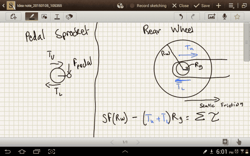

Is this right?
Handwritten notes on grid paper: left, a rear gear circle with tension T_u on top and T_l below, a force arrow SF, and the equation tau_SF - (T_u - T_l)R_g = 0; right, a pedal sprocket with tension T_u and T_l, a pedal force arrow, and the equation tau_p - (T_u - T_l)R_p = 0.
I think I understand that the tension in the upper chain would pull left in reaction to being pushed downward by the sprocket. But why should the lower chain also pull left? It would seem that it would react to the sprocket's force by pulling right.
Also, are we assuming that the bike is traveling at a constant velocity? Otherwise the moments wouldn't balance, correct?
It doesn't matter what direction you draw the chain forces as long as they are consistent between the front sprocket and the rear sprocket. In your most recent diagram, they are consistent.
If we neglect the rotational inertia of the rear wheel and of the pedal assembly, then the moments must balance even if the bike is accelerating. (If I = 0, then Iα = 0).
