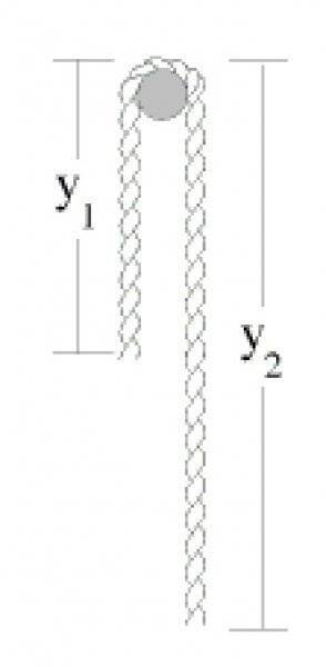

A limp rope with a mass of 2.4 kg and a length of 1.5 m is hung, initially at rest, on a frictionless peg that has a negligible radius, as shown in the Figure. y1 is equal to 0.48 m. What is the vertical velocity of the rope just as the end slides off the peg?
PE = mgh
KE = 1/2mv^2
Because the kinematics of this system seemed incredibly complicated, I figured it best to use conservation of energy in the system. Knowing that the center of mass will fall 0.48 meters, I assumed:
mgΔH = 1/2mv^2
2.4*9.81*0.48 = 1/2*2.4*v^2
v = 3.06881084461 m/s
Unfortunately, this seems to be incorrect.

How do you know the answer is incorrect?
Some of the rope is falling, but some of the rope is lifting. How did you account for the work done lifting part of the rope?
The behavior is not kinematic - since the acceleration will not be constant.
You can, however, use Newton's laws or conservation of energy to set up a differential equation.

My apologies. Here's the image.
Cool - that's what I figured: what about the questions in post #2?
