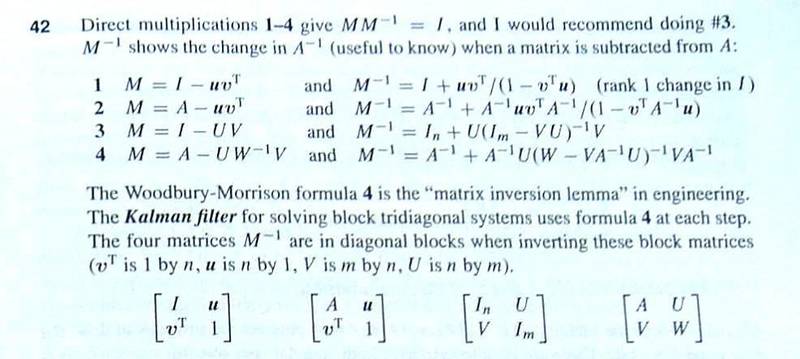

It's from the chapter on Matrix Inverses...
imgur link: http://i.imgur.com/8OhFzgi.jpg
This is the entirety of the exercise. It's not following on from or setting anything else up. That's just number 42...what can I do with this?
I don't see a question.
You can show that MM-1=I in each case.
What are the four block matrices at the bottom all about?
The matrices above seem to help if you want to invert the block matrices below.
