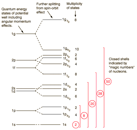

I'm not very familiar with these shells, but they enclose each other? One thing I don't understand then, though, if I look at this image:
The red part. It looks to me like each shell needs its own amount to be full, which are equal to the magic numbers. So if the first two shells are full, it should be the most stable (for a two-shell atom), right? But Z and N wouldn't specifically be equal to the magic numbers.

Then wouldn't 0 be the most stable state and not the magical numbers? Maybe I'm confusing things now.
You are indeed confusing : link in post 8, Fe56 is the most stable configuration, for which the nucleons are the most strongly bounded together. You can also see in the "Fission and fusion can yield energy" graph, that even for light nuclei, the binding energy raises very fastly. The local maximums can also be understood in "Binding Energy for the Last Neutron as Evidence of Shell Structure" in the link of post 7.
When one shell is closed, it is not easy to take away a nucleon by striking it. It holds with his buddies together. If there is a "hole" in the structure, it gets weaker. It is the same in football I guess.
