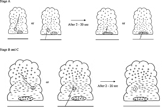

@Edison Bias
Two theories exist to explain generation of the main cumulonimbus cloud charge dipole: (1) precipitation, (2) convection, viewed as less significant.
In precipitation theory, heavy falling precipitation particles interact with lighter particles carried in updrafts. The interaction process serves to charge the heavy particles negatively and the lighter particles positively., after which updrafts and gravity separate the opposite charges to form a positive cloud dipole. Charge transfer can be by collision in which two initially uncharged precipitation particles become, after collision, oppositely charged, for example in collision between hail and ice crystals. Or charge transfer can be by induction in which two uncharged but electrically polarized precipitation particles collide in such a way that the small, light hydrometeor absorbs charge from the bottom of the larger heavy precipitation particle, as the light particle moves upward. The induction process serves to enhance the initial field in which it operates.
In convective electrification theory, charge accumulated near the Earth's surface or across region of varying air and cloud conductivity is moved in bulk to the observed locations by the air flow associated with the thunderstorm.
The small positive charge region at the base of the cloud may not be present on all thunderstorms, or may simply be well localized and difficult to detect.
A fundamental problem in developing an essentially static cloud charge model is that neither the fields nor the charges that produce them are really steady in time.
The above is after Uman, 1987
http://onlinelibrary.wiley.com/doi/10.1029/2006JD007820/full
Abstract
[1] Evolution of lightning activity in a tropical hailstorm of moderate size that developed in the premonsoon season at Pune (18°32′N, 73°51′E, 559 m above sea level) is studied from the measurements of surface electric field, the Maxwell current and thunder. Total flash rate is counted from the electric field record, and the cloud-to-ground (CG) flash rate is estimated from the visual observations. Precise timings of their occurrence were confirmed from the observations of overshoot in the Maxwell current records. The storm exhibited an almost constant rate of one CG flash every 1 to 2 min over the whole life time of the storm. The ratio of intracloud (IC) to CG flashes (IC/CG) increased with the increase in total flash rate. In the convective stage of the storm, field changes from consecutive flashes were generally found to alternate in polarity. Moreover, in this stage, field changes occur in pairs, the first field change of each pair being of negative polarity and the second one of positive polarity. The two field changes in a pair occur with an average time difference of 14.3 ± 8.4 s while two consecutive pairs appear after 29.3 ± 9.1 s. In between the convective and mature stages, our observations suggest the occurrence of the phenomenon of rain gush and the field excursion associated with falling precipitation. Development of the mature stage was marked with rapid transitions in the surface electric field and the Maxwell current polarities from negative to positive. Further, total flash rate and IC/CG ratio sharply increase, and the lightning-induced electric field changes become almost exclusively of negative polarity. Observations suggest possibly a lifting up of the charging region in mature stage of the storm. The dissipating stage of the storm witnessed hail and rain showers, sharp transition of electric field and the Maxwell current from positive to negative polarity and occurrence of a few positive CG discharges. Our observations are consistent with the general belief that that some lightning flashes, by neutralizing and depositing charge in the region of opposite polarity, change the charge distribution so as to trigger another discharge in the storm.
[3]. ...in the most widely accepted of the thunderstorm charging mechanisms, interactions between graupel and ice crystals in presence of supercooled water result into charging of graupels with negative charge and ice crystals with positive charge when the graupels are growing by sublimation. The subsequent differential separation of particles under gravity is then assumed to cause creation of positive dipole.Results of the laboratory experiments of Reynolds et al. [1957], Takahashi [1978], and Saunders et al. [1991]suggest that the same charge separation mechanism can charge the graupel positively and create LPCC in tripole electrical structure when the graupel is undergoing deposition [Williams, 1989; Williams et al., 1991; Murphy et al., 1996]. Mansell et al. [2005] propose that inductive charging of particles in the lower part of cloud under the influence of overhead charge may be responsible for the LPCC. Observations of Holden et al. [1983], Marshall and Winn [1982], Mo et al. [2002], Coleman et al. [2003], Warner et al. [2003], and Rust et al. [2005] suggest that some flashes may deposit positive charge in the base of a thundercloud and thus act to generate the Lower Positive Charge Center (LPCC)...
[4] The presence of ice crystals and graupel is considered as fundamental for strong electrification and lightning
[5] Electrical processes operating inside thunderstorms generate large currents and the charges deposited by them considerably influence the Maxwell currents flowing outside the cloud. Therefore the Maxwell current flowing beneath a thunderstorm has often been interpreted to reflect the electrical processes occurring inside thunderstorms [Krider and Musser, 1982; Krider and Blakeslee, 1985]. For example, Krider and Musser [1982] equate the Maxwell currents to the charging currents in thunderstorms under conditions of low electric field, no precipitation and no lightning currents.
Hide
Figure 9
A schematic diagram to explain the frequent occurrence of pairs of the lightning-induced field changes in stage A as compared to other stages of the thundercloud.
