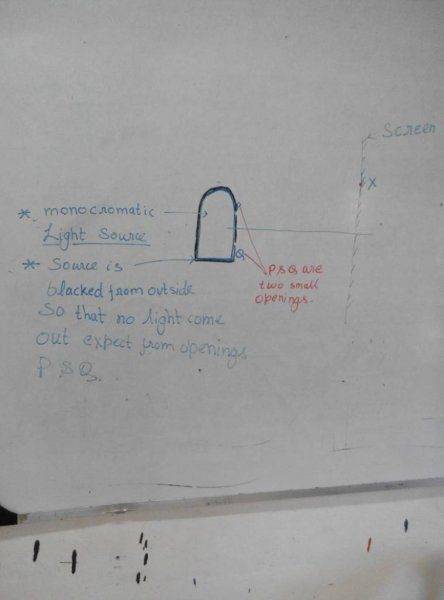

No. See I am looking for the answer that if at ****t=0***, the phases of waves from P and Q at their x=0(x=0 for both that at their points of emergence) be same or Not? Remember I has been talking about a source which(magically or otherwise) producing monochromatic(wave of single frequency. My question for phase here is for positions x=0 for both P and Q. I think the answer belongs to some other similar question. And I do not understand what you mean when you say "if we allow Q to vary" what thing you want to vary about Q? Frequency or position or time of observing Q? My Q is fixed point on the source(that is at x=0) my source is producing constant frequency I just want an account if at t=0, the phases of waves emerging from P and Q will have same phase at their x=0(at their respective point of emergence at a same time say t=0).
  • #34
Drakkith said:
The phase of the wave at any point changes over time, whether the wave is monochromatic or not. If we say that at t=0 the electric field amplitude of a 1 Hz wave is at zero, then the phase is also at 0 degrees. 1/4 second later the phase will have changed by 90 degrees and the electric field amplitude will be at maximum. At 1/2 second the phase will be at 180 degrees, the amplitude will be zero again, but will be changing towards the opposite polarity from where it just was.

I am asking if I focus simultaneously at two points P and Q of my illuminated source(monochromatic). Say I note the phase of wave from P( at x=0,t=0) as alpha. Will the phase of wave from Q(at x=0,t=0) which I noted will come alpha or not?
  • #39
I already answered this in post #26. The phase is identical at both points.

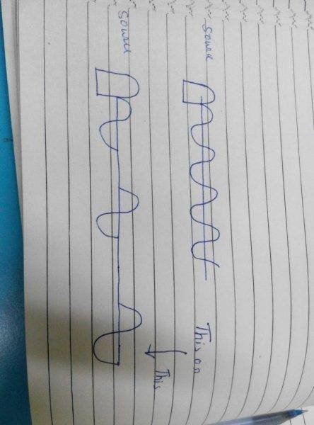

  • #44
Here I attach the picture of the content of my textbook saying Young Locked the phases. I created this thread for a search that if he had to lock the phases(which would be changing) due to the problem with his source that sodium source undergo abrupt phase changes or due to problem of frequency. Initially it was told to me here that one can't change phase without change in frequency and that phase and frequency can't be changed independently. Later today Drakkith talk more openly saying the phase of wave(at x=0,t=0) varies no matter source is monochromatic or not. Means even if frequency do not change phase can change. I was after this from many days and today only he accepted it.
My last question that I posted today that if the phases of waves from P(at t=0,x=0) and Q(at t=0,x=0) has a physical importance to answer, what actually was Young controlling (to get a constant phase); the changing frequency(with time) of wave from a single point of main source or that he could not use a single source(monochromatic) as coherent source because the different points on the source(at t=0,x=0)have different phases(the reason which I felt). According to me if at the different points say P and Q of the (monochromatic) source he could get waves with same phase(at t=0,x=0) he would let the interference happen with only one source since such a hypothesis that phases of P and Q of, (monochromatic) source will be same(at t=0,x=0) will about to talk the single source as being coherent source. In that case he won't need two slits. If at any time the waves from different points of sources emerges with common same phase.
  • #45
You are being too literal here. Note that the phrase "Locked the Phases" is in inverted commas. What it means is that the wave trains from the original source are long enough that, when they reach the two slits, they have traveled near enough the same distance to behave as if they were "locked". What "locking" mechanism could Young have possibly used in the 18th Century? He was just relying on the relatively high level of coherence between the waves on the two paths to the slits. If he had illuminated the two slits by offsetting the light source to one side, the coherence would have deteriorated because the beginnings and ends of the wave trains would no longer coincide at the slits.
In non-laser sources, we are dealing with a large number of atoms that emit their photons in no particular phase relative to each other. That means that the coherence length is very short and you have to use symmetry to help you.
You are applying the 'rules' of discussing ideal theoretical sources with the realities of using simple (ancient) sources. The reasoning behind the simple treatment of Young's Slits is flawed, in fact, if you try to apply it to the real world. But the same goes for all simple electrical and mechanical treatments and you need to approach these things from a mature standpoint. It is fatal to try to 'classify' to slavishly in these things.
In the Young's experiment, there is only one source and what Young was really dealing with was the diffraction pattern of all three slits. It just so happens that you can use symmetry to simplify it down to the pattern of the two front slits.

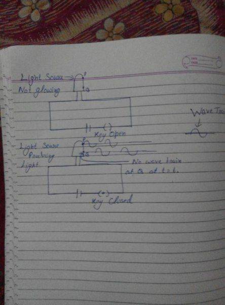

  • #55
What I wanted to say is that, let P and Q be two points on a single source of (monochromatic) light. I believe light from both points P and Q will be emitted, each time their(at P and Q) is light producing mechanism(electron jump/movement etc) happen, wave train (of light wave) is emitted(from P is mechanisms happen at P and at Q if mechanism happen at Q). And there is a possibility that at any time light producing phenomenon may take place at P and not at Q at that instant, rather light producing phenomenon(electron jump/movement) is highly random so wave train may be emitted by point Q also but at later time or it(Q) had emitted a wave train earlier than P does. Below is a picture I draw about this understanding of mine. Every help will be highly appreciated.
Regards
  • #56
Regards
But you cannot 'turn on' a LED and expect a photon to be emitted at a fixed time after your turn on time. The only way you can ensure that happens is inside a laser when one photon stimulates an atom to emit its photon. That would be within one source and at a quantum level of things - no electrical switches involved. Actually, you can use light from one laser to cause a second laser to emit light that is coherent to it and, that way, you could arrange for two lasers to be synced together and produce beams with a high level of coherence. (But this point has already been made before, I think).
You have to be careful not to try to impose classical ideas of waves on what photons do. It doesn't work very often.

Now you're getting into non-ideal light sources and non-classical physics.
  • #58
I am not expecting that a photon will be emitted at FIXED time after I turn on light rather I learn that emission of photon from a light source is a random phenomenon, random in the sense that the time duration between emission of two successive photons from a given point also it(randomness here) means(as what I understood and depicted in my earlier post) that their is no surety that any two points of the source at any given time is emitting any photon at the first place.
Is it true(what I mentioned) that their can be a wave train from P(means P is emitting photon) while no wave train from Q at the same time(that is no photon emission from Q at that instant) or my this thinking is wrong rather the whole source is illuminated as result of single photon emission within the bulk of the source causing simultaneous emissions of any points be it P and Q, making both points producing wave train simultaneously. And their is no such that that P is emitting wave train but Q is not.
I am not very good at Physics expecially when certain subjects need to look from different angles in different circumstances. I have what no idea how else I clear my doubts. I was not expecting understanding something about light sources would be so difficult :-( and when to take classical model and when something else.
