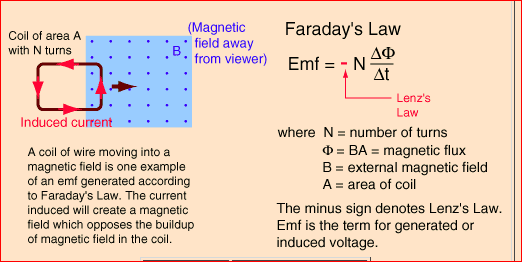

From the voltage, the frequency, and the area of the loop you can then calculate the amplitude of B in Vs/m^2 = tesla.
http://hyperphysics.phy-astr.gsu.edu/hbase/electric/farlaw.html

Now, your equation. Shouldn't turns be taken into account?

The maximum frequency will probably be limited by the conversion speed of the ADC. To see the waveform, you need to sample with at least twice the frequency of the magnetic field.
Of course, if you use a coil, number of turns must be taken into account. But if you are afraid of frying your inputs, you could start with a loop (one turn), small area, and large distance. Main question may be what negative voltages the input can tolerate. If the inputs are not diode protected, you can add them. And/or a dc bias.

As Piet showed,
E = N dΦ/dt
so for sinusoids only,
Φ = E/(N X 2Πf) and you know area of your coil
i've done that for 60hz fields using ten turns on 1/10th square meterSince most true RMS voltmeters aren't very fast ( even good ones like Fluke 289 only go to ~100khz )

So.
Tesla = Volts / (Turns * 2(3,14*frequency))
No, that's Webers
Tesla is Webers per square meter

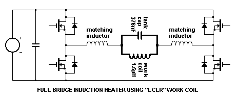

Well.
Your idea is nice, but 200khz is only an approximation of the real frequency. The switches are a full-bridge of FGH60N60SMD IGBTs, connected in this configuration (with some added protection for the bridge)
You should also ignore the values on the capacitor and the inductor, as I just pulled that image from a website. The inverter will actually run at 170 KHz, but considering that since the resonant frequency of the LCLR tank changes as its surroundings change(stuff is inserted and taken out of the coil) therefore I consider the frequency to be variable within a range, the 200 KHz I was using earlier is just a rounded number.
The controller circuitry is a STM32F7 Discovery board, which runs at 216 MHz, which will be used to track the resonant frequency of the tank by measuring the output changes through the measuring sensor we're discussing. As I understand, going below or above resonance decreases output, so resonance can be found and tracked by simply increasing/decreasing the frequency and checking against the values returned from the sensor. The initial frequency which will be increased/decreased from will be the calculated resonant frequency of the LC tank, which I am unsure of, because this project is still in the form of ideas and blueprints.
Further, the powerful microprocessor will display an interface on the capacitive-touch screen that comes with the board that allows changing the power (amplitude) by adjusting the phase-shift between the 2 "legs" of the full bridge inverter, turning off frequency tracking and setting the frequency manually, the interface will show also the power of the magnetic field, which is also derived from the sensor we're discussing, in-addition to any other gimmicks that I'm asked for.
So, from the switching devices, it will indeed be a pretty powerful device, considering it should be able to take 120 amps in if I could keep the bridge cool enough, but I'm not planning to do that, because I simply can't source 300V (rectified EU mains) at 120 amps, so it'd be run at 20 amps, which is about 4kW, at max power. I'm planning to cool the bridge using 4x (1 per IGBT) tiny (when compared with the monstrous copper-piped heatsinks you find today) processor heatsinks (think the stock ones that come with intel processors, but slightly smaller and without fans), which will have a single bigger fan blowing air on all the four of them.
The work-coil will be cooled via water, since it's basically copper pipe, and since the capacitor will be a bunch of CDE 940C20P1K-F, which cannot be cooled via water, I suppose I'll simply just use another fan on them.
So, all that above is simply the current ideas about the project, with probably a lot of un-related stuff, but it helps to have background, I suppose.

grim3271 said:
T = Weber/meter squared, so assuming just 1 meter squared, it'd be T = Weber. I still don't get what the area of the coil has to do with this. Sorry, but this is kind of confusing me.
Back to Faraday, Piet's hyperphysics link
flux encircled by your search coil is Φ and is Webers. Flux used to be called Lines in cgs days when i started, later Maxwells, when we went SI it became Webers
Flux density is B, Webers per square meter or Tesla, used to be called Gauss in cgs days and was one line(Maxwell) per square centimeter, ~same order of magnitude as Earth's magnetic field. a far weaker field than a Tesla ,
10^4 gauss is a Tesla
that'd be 10^4 lnes per square cm which is 10^8 lines per sq meter
and 108 Maxwells make a Weber(that's my own internal cross check on my thinking - i can't remember that stuff so have to reason it out every time and check against Wiki and I'm mistake prone so you should check me too)
so -
a search coil of diameter 2/√pi cm would have area pi X (2/√pi)2/4 = 1 square cm = 10-4m^2
and when placed in in a sinusoidal AC field of 1 tesla peak would encircle flux B of 1Tesla X A of 10-4m^2 sin(wt) Webers
so it'd produce 10-4 wcos(wt) volts
200khz is w of 1.257E6
so your search coil should produce ~126 volts per turn per tesla at that frequency
2/√pi = 1.128 , so i described a search coil of diameter 0.444 inch
If one connects 126 volts 200khz to series combination of 10K and 0.05 uf
what current will flow? What's voltage across the capacitor? How much power is dissipated in the resistor?

I notice your capacitors are rated 8 amps RMS so it'd be nice to know whether your machine is producing sinusoids or something with higher crest factor. Polypropylene has low melting point and we had some SCR snubbers made of it melt, replaced them with oil filled metal can capacitors made for commutating service . Feel of them early in your testing.
Thanks for the diagrams of your project
i'm not close to my project yet
but your resonance idea is intriguing it should encourage sinusoids...
hmmm... current gain of a parallel resonant circuit... watch those caps
so -
Is that a practical experiment to make with a DMM in order to figure out whether you dare connect an expensive ADC ?
old jim

Field strength in Tesla * Area of coil * 2 * 3.14 * Frequency = Volts per turn per Tesla
therefore
Peak field strength in tesla = V/turn / (Area of coil * 2 * 3.14 * frequency)

Also, using the inverter board from a microwave seems like a nice idea, you can even use the ferrite from that transformer that comes with it for the matching inductor, then you'd only need to supply a capable capacitor, a coil, and cooling for the coil. But if it uses PWM for power control, then that'd be a problem for higher powers, because flyback currents, also I think you'd have trouble changing the frequency, unless it's a self-tuning inverter, which I doubt it is since manufacturers like to skimp as much as they can on these things.
Well, I found those capacitors to be recommended around the web, 20 of them should give 160A Rms, I think they should be fine with a fan. Those were the most economical (Specs per dollar) capacitors I could find, if you have any suggestions for more economical ones, please give them to me!
Here's an excellent resource on the LCLR topology. ==> http://www.richieburnett.co.uk/indheat.html

True, that's also the reason why the matching inductor should be made out of litz wire, as only 0.146mm of the wire will be used. (assuming it's copper)
