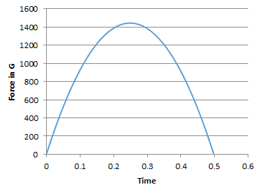

This smells like I need to use integrals. So I looked up some more info and scratched my chin until it was a little sore. So far I'm gathering from your comment that the shock impulse should look like the following graph, (that I'm assuming too much that the acceleration is constant) and that I need to invite some integrals to this dance party. Did I read your comment correctly?

Well, the force increases to a maximum and then decreases back to zero. That much you can assume.
But it does not have to be symmetric around the maximum. And does not have to be parabolic (I suppose your curve is a parabola. At least it looks like one :) ).
What I was trying to say is that the shape and width of this curve depends on the two materials colliding and maybe on the speed of impact.
But still is not too clear what are you trying to do. are these values (0.5 ms and 1500 g) results of some measurement? If yes, was this done on an actual falling body?

Hi Nasu, I think I follow your explanation. It makes sense to me when I exaggerate the surface properties like you did (a trampoline or concrete). In regards to your questions:
1.) The parabola was a generic approximation for the sake of simplicity and also for saving the last of my brain cells for that day.
2.) 0.5 ms and 1500 g are input variables to a test for an object conducted by a third party.
3.) I get the results of this test passed back to me in the terms of 'pass/fail' depending on if the object breaks or not. Without knowing their test procedure, I'm ultimately trying to quantify what the test means in real life - as one who usually sits in the back of a room full of smart people, I have a hard time trying to keep up with those who throw around these kinds of numbers at whim and can comprehend their significance. This is my effort to make more wrinkles in my brain. It's one thing for me to hear "wow, it survived 18 impulses of 1500G @ 0.5ms, eh?", it's another for me to hear "wow, that clumsy guy dropped it 17 times while he crossed the street and then it fell from his hands one last time where he accidentally kicked it to the curb 3 feet away and it still works, eh?"
If this is the case, maybe you can ask them what do they mean by that value of acceleration. Is it the average value or maybe the peak value (or something else)?
I understand your goal. Unfortunately there is no a straightforward answer unless you know detail properties of the object itself. As I understand it, the 0.5 ms does not refer to the time the object was actually stopped from free fall but to the time they conducted their (unknown) test.
