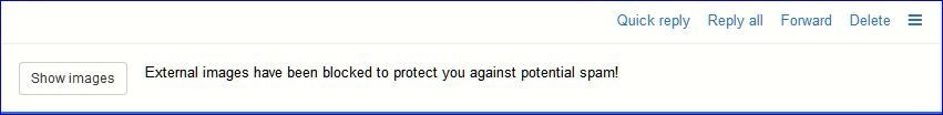

Every client is different, but disabling the remote images will eliminate most tracking.
This is how mine works. . .
