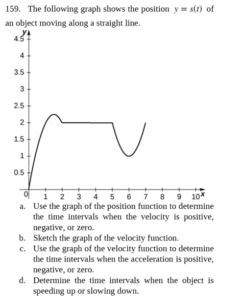

Use the graph (attached below) to determine the time intervals when the velocity is positive, negative, or zero.
The graph is of a position function.
Velocity is the derivative of position.
Velocity will be zero when the derivative of the position function is zero. In other words, where the tangent line to a point on the graph of the position function is horizontal.
On the intervals (2,5) it is clearly horizontal. However, at x=1.5 and x=6, the velocity should also be zero because the derivative at these points would be a horizontal tangent line.
Now in my book, it says that the velocity is zero on (2,5). And that is all.
Is my reasoning off with this? The velocity should be zero on the interval (2,5) as well as at the points x=1.5 and x=6.

I agree w/ you but perhaps they don't consider an "interval" of 0 seconds to be an "interval". If that is in fact their reasoning, I think they are wrong and I can't see any other way ANYONE could consider them right.

Thanks for the reply. And further, for part c, it asks for the positive, negative, and zero acceleration. Again, the solution doesn't account for the actual points where the acceleration is zero i.e. where the graph of the velocity function crosses the x-axis.
I'll play ball with the question, I just wanted to make sure that my reasoning was at least correct.

You want to look at concavity of the position function to find out about acceleration. And that particle is surely behaving oddly. It is at rest on ##(2,6)## then suddenly, with positive acceleration, moves in the negative direction. How does that happen?

And that particle is surely behaving oddly. It is at rest on (2,6)(2,6) then suddenly, with positive acceleration, moves in the negative direction. How does that happen?
So to answer this question, let me see if I can interpret this graph correctly without doing the math.
By your comment, concavity of a position function relates to acceleration.
So in looking at the graph I will say that on the interval (0,1.5) it in convex which I assume means negative acceleration. This makes sense because at x=1.5 the particle has stopped, meaning it was slowing down to this point.
However I'm not sure if my reasoning holds for intervals (1.5, 2) because that would mean that from a stop, it then gets negative acceleration and my intuition tells me that to move from a stop you would need positive acceleration.

Concave down corresponds to negative acceleration and concave up to positive acceleration.
After it stops it starts moving in the negative direction for ##t## in ##(1.5,2)##which is caused by the negative acceleration. All good so far. But that sharp corner in the graph means it suddenly stops and the acceleration jumps to zero. It is the next sharp corner at ##t=5## that is strange. It suddenly goes concave up (positive acceleration) while moving from rest to a negative velocity. So I guess it is a make-believe problem or subject to some strange undefined surroundings.

Other way round. "Concave" is "bending inward". So if it is open upward, with the inward curve facing up like a bowl or in your terminology "valley-like", that is "concave up". And if it is the other way round, with the hump facing up and the inward concave curve on the bottom, that is "concave down".
"Convex" is sticking out, "concave" is bending in.
If it is valley-like or bowl-like, then the slope is negative before the bottom of the bowl and positive after. The velocity is increasing. That is a positive acceleration. So concave up does correspond to positive acceleration. But it's the valley-like picture that is concave up.

Are we considering the "bowl" to be the position function? Because if we are, I would be inclined (pun intended) to say that the velocity before the bottom of the bowl is negative, then positive after the bottom of the bowl.
And if I think about the concavity of the bowl on the positive velocity side, it looks like " ) ". I'm throwing me self for a bit of a loop here because I can see that the slop would be increasing and thus the velocity in increasing. So then if velocity is increasing we can deduce that acceleration is increasing?

No. Geometrically, concave up is like a smile or a bowl which will hold liquid. Frown or turn the bowl upside down for concave down. Note that concavity is not the same thing as slope. You can have very gently or very steeply sloped curves of either concavity.
You are conflating increasing and positive. If the position is increasing the slope is positive. If the slope is increasing the concavity is positive. With regard to the red sentence, if the velocity is increasing you can deduce the acceleration is positive, not that it is increasing.

Acceleration in the colloquial sense is different than what the term means in physics and math.
An object speeds up if the velocity and acceleration have the same sign. In particular, if they're both negative, the object is speeding up. Negative acceleration isn't equivalent to "slowing down," nor is positive acceleration equivalent to "speeding up."

The second derivative at ##t=5## is undefined. Physically, you can think of the object being given a sharp whack at that instant, setting it in motion in the negative direction.
