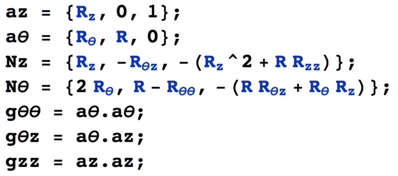

What we are going to do next is focus on a tiny window of curved free surface between the grid lines ##\theta## and ##\theta + d\theta## in the ##\theta## in-plane direction, and the grid lines z and z + dz in the z in-plane direction. The opposite edges of this tiny window are not quite parallel to one another, nor are they quite perpendicular to their adjacent edges. We are going to do a force balance on the tiny window to derive the relationship between the normal force exerted by the pressure differential across the window and the surface tension forces at the edges of the window.
To do this force balance, we are going to need to derive equations for the two unit normal in-plane vectors to the grid lines of constant ##\theta## and z within the surface. We need these because the surface tension forces at the edges of the window act perpendicular to the edges.
To implement this derivation, we first define two in-plane "reciprocal coordinate basis vectors" ##\hat{a}^{\theta}## and ##\hat{a}^z## within the surface as follows:
##\hat{a}^{\theta}\centerdot \hat{a}_z=0## and ##\hat{a}^{\theta}\centerdot \hat{a}_{\theta}=1##
and
##\hat{a}^{z}\centerdot \hat{a}_{\theta}=0## and ##\hat{a}^{z}\centerdot \hat{a}_{z}=1##
So ##\hat{a}^{\theta}## is perpendicular to the lines of constant z, and its orientation and magnitude are such that it is at a typically small angle to the lines of constant ##\theta##, and the product of its magnitude with that of ##\hat{a}_{\theta}## times the cosine of the angle between them is equal to unity. A similar geometric interpretation applies to ##\hat{a}^z##.
In this derivation, what we are going to do is express ##\hat{a}^{\theta}## and ##\hat{a}^z## each as a linear combination of ##\hat{a}_{\theta}## and ##\hat{a}_z##. For ##\hat{a}^{\theta}##, we first write:$$\hat{a}^{\theta}=A\hat{a}_{\theta}+B\hat{a}_z$$where A and B are coefficients (to be determined). If we dot ##\hat{a}^{\theta}## with ##\hat{a}_z## and ##\hat{a}_{\theta}##, we obtain:
$$\hat{a}^{\theta}\centerdot \hat{a_z}=g_{\theta z}A+g_{zz}B=0\tag{4a}$$and$$\hat{a}^{\theta}\centerdot \hat{a}_{\theta}=g_{\theta \theta}A+g_{\theta z}B=1\tag{4b}$$where the three "metrical coefficients" for the surface, ##g_{\theta \theta}##, ##g_{\theta z}##, and ##g_{zz}##, are defined by:
$$g_{\theta \theta}=\hat{a}_{\theta}\centerdot \hat{a}_{\theta}\tag{5a}$$
$$g_{\theta z}=\hat{a}_{\theta}\centerdot \hat{a}_{z}\tag{5b}$$and $$g_{zz}=\hat{a}_{z}\centerdot \hat{a}_{z}\tag{5c}$$
Now its your turn. Please solve Eqns. 4 for the coefficients A and B in terms of ##g_{\theta \theta}##, ##g_{\theta z}##, and ##g_{zz}##, and then write out the equation for ##\hat{a}^{\theta}## in terms of these.

Ahhh this is related to covariant and contravariant vectors, right? I think I've done this before but it was about a year ago. At any rate, we have $$A = \frac{g_{zz}}{-g_{\theta z}^2+g_{zz}g_{\theta\theta}}\\
B = \frac{g_{\theta z}}{g_{\theta z}^2-g_{zz}g_{\theta\theta}}\implies\\
\hat{a}^\theta = \frac{g_{zz}}{-g_{\theta z}^2+g_{zz}g_{\theta\theta}}\hat{a}_\theta+\frac{g_{\theta z}}{g_{\theta z}^2-g_{zz}g_{\theta\theta}}\hat{a}_z.$$
Sorry my response took so long. I should now be able to respond much faster (very busy week for me).

Good. Next, determine the magnitude of ##\hat{a}^{\theta}## in terms of the g's. Then, divide ##\hat{a}^{\theta}## by its magnitude to get the in-plane unit vector ##\hat{u}^{\theta}## in the direction perpendicular to ##\hat{a}^z##.

I think that ##\hat{a}_{\theta}## and ##\hat{a}_{z}## are not orthogonal, nor are they unit vectors.
Riiiiiiight, as you said bevore $$\hat{a}_\theta=\frac{\partial R}{\partial \theta}\hat{r}+R\hat{\theta}\tag{3a}$$and$$\hat{a}_z=\frac{\partial R}{\partial z}\hat{r}+\hat{z}\tag{3b}$$
My bad. So I would take the norm by transforming back to these definitions. Somehow I have a feeling you have a more general approach? Could you share it and I'll do the footwork? I'd like to see how to take a vector norm with non-orthonormal basis vectors.
Just use Eqns. 5 in post #35.
I tried thinking about how equations 5 help, but I can't see how. At any rate, we have
$$\hat{a}^\theta = \frac{g_{zz}}{-g_{\theta z}^2+g_{zz}g_{\theta\theta}}\hat{a}_\theta+\frac{g_{\theta z}}{g_{\theta z}^2-g_{zz}g_{\theta\theta}}\hat{a}_z \\
=\frac{-g_{zz}}{g_{\theta z}^2-g_{zz}g_{\theta\theta}} \left( \frac{\partial R}{\partial \theta}\hat{r}+R\hat{\theta} \right)+\frac{g_{\theta z}}{g_{\theta z}^2-g_{zz}g_{\theta\theta}}\left( \frac{\partial R}{\partial z}\hat{r}+\hat{z} \right)\\
= \frac{g_{\theta z} \partial_zR -g_{zz} \partial_\theta R}{g_{\theta z}^2-g_{zz}g_{\theta\theta}} \hat{r} +
\frac{-g_{zz} R}{g_{\theta z}^2-g_{zz}g_{\theta\theta}} \hat{\theta}
+ \frac{g_{\theta z} }{g_{\theta z}^2-g_{zz}g_{\theta\theta}} \hat{z}$$
where from here I could compute the norm as a regular problem. Would you mind highlighting the procedure you referenced, involving equations 5? Again, I'm sorry for the amount of time it's taken for me to reply!
$$\hat{a}^{\theta}=\frac{g_{zz}\hat{a}_{\theta}-g_{\theta z}\hat{a}_z}{g_{zz}g_{\theta \theta}-g_{\theta z}^2}$$
$$\hat{a}^{\theta}\centerdot \hat{a}^{\theta}=\frac{(g_{zz}\hat{a}_{\theta}-g_{\theta z}\hat{a}_z)\centerdot (g_{zz}\hat{a}_{\theta}-g_{\theta z}\hat{a}_z)}{(g_{zz}g_{\theta \theta}-g_{\theta z}^2)^2}$$
$$\hat{a}^{\theta}\centerdot \hat{a}^{\theta}=\frac{g_{zz}^2(\hat{a}_{\theta}\centerdot \hat{a}_{\theta})-2g_{\theta z}g_{zz}(\hat{a}_z\centerdot \hat{a}_{\theta})+g_{\theta z}^2(\hat{a}_z\centerdot \hat{a}_z)}{(g_{zz}g_{\theta \theta}-g_{\theta z}^2)^2}$$
$$\hat{a}^{\theta}\centerdot \hat{a}^{\theta}=\frac{g_{zz}^2g_{\theta \theta}-2g_{\theta z}^2g_{zz}+g_{\theta z}^2g_{zz}}{(g_{zz}g_{\theta \theta}-g_{\theta z}^2)^2}$$
$$\hat{a}^{\theta}\centerdot \hat{a}^{\theta}=\frac{g_{zz}(g_{zz}g_{\theta \theta}-g_{\theta z}^2)}{(g_{zz}g_{\theta \theta}-g_{\theta z}^2)^2}$$
$$\hat{a}^{\theta}\centerdot \hat{a}^{\theta}=\frac{g_{zz}}{g_{zz}g_{\theta \theta}-g_{\theta z}^2}$$
Riiiiiight, the magnitude of any vector ##\vec v =\sqrt{ \vec v \cdot \vec v}## since ##\vec v \cdot \vec v = |v| |v| \cos \theta = |v|^2##. Shoot, this makes perfect sense now! Okay, so I agree the magnitude is $$\frac{\sqrt{g_{zz}}}{\sqrt{g_{zz}g_{\theta \theta}-g_{\theta z}^2}}.$$ From the above we know
$$\hat{a}^\theta = \frac{g_{zz}}{-g_{\theta z}^2+g_{zz}g_{\theta\theta}}\hat{a}_\theta+\frac{g_{\theta z}}{g_{\theta z}^2-g_{zz}g_{\theta\theta}}\hat{a}_z\implies\\
\hat u^\theta = \sqrt{g_{zz}}\hat{a}_\theta - \frac{g_{\theta z}}{\sqrt{g_{zz}}}\hat{a}_z\\
=\frac{g_{zz}\hat{a}_\theta - g_{\theta z}\hat{a}_z} {\sqrt{g_{zz}}}.$$
How does that look?

Yea, I dropped a term in the algebra. We should have
\hat u^\theta
=\frac{g_{zz}\hat{a}_\theta - g_{\theta z}\hat{a}_z} {\sqrt{g_{zz}}\sqrt{g_{zz}g_{\theta\theta}-g_{\theta z}^2}}.$$
\hat u^\theta
Right. Now, by extension, please write down what ##\hat{u}^z## would be.
