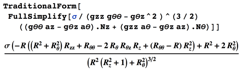

Chestermiller said:
I confirm all those components.
Ok, then here is what follows:
Mathematica input in TraditionalForm: FullSimplify of sigma divided by (gzz g00 - g0z^2) to the 3/2 power, times ((g00 az - g0z a0).Nz + (gzz a0 - g0z az).N0), followed by the simplified fraction output in traditional notation.
Notice I used the FullSimplify command, so ideally this is concise. It's not the same as yours (I input that in already). My results based on post 84
  • Mathematica input in TraditionalForm: FullSimplify of sigma divided by (gzz g00 - g0z^2) to the 3/2 power, times ((g00 az - g0z a0).Nz + (gzz a0 - g0z az).N0), followed by the simplified fraction output in traditional notation.
joshmccraney said:
Ok, then here is what follows:View attachment 220354
As best I can tell, this is equivalent to what I had.
Shoot, maybe I typed it into Mathematica wrong. So, if both are correct, then we're good?
Yes. But, I'd also like to include the viscous part of the stress in the boundary condition at the free surface. In terms of the components of the stress tensor (in cylindrical coordinates) and our equation for the normal to the free surface, what is the traction vector at the free surface?

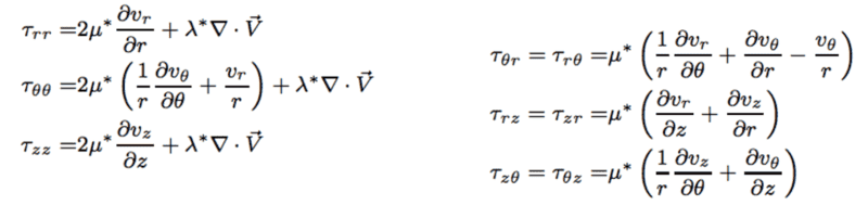

If the stress tensor is ##\sigma## then are you asking for ##\sigma \cdot \hat N##? Shouldn't we instead take ##\sigma \cdot \hat u_z## and ##\sigma \cdot \hat u_\theta## since we're concerned with finding shear? Evidently the stress tensor ##\sigma## has components
Two columns of cylindrical-coordinate viscous stress expressions: tau_rr, tau_thetatheta and tau_zz in terms of mu*, partial derivatives of v_r, v_theta, v_z, and lambda* times the divergence of V; and tau_rtheta, tau_rz, tau_ztheta given as mu* times combinations of partial derivatives.
where we can obviously omit the ##\nabla\cdot\hat V## terms (incompressible). So the matrix appears as
\sigma =
\begin{bmatrix}
\tau_{rr} & \tau_{r\theta} & \tau_{rz}\\
\tau_{r\theta} & \tau_{\theta\theta} & \tau_{\theta z}\\
\tau_{rz} & \tau_{\theta z} & \tau_{zz}
\end{bmatrix}
and ##\hat u_z,\hat u_\theta## have bee previously defined. What do you think?

I'd like to see (in terms of the tau's),$$\hat{\sigma}\centerdot \hat{n}$$The above is the viscous stress (traction) vector at the interface
$$(\hat{\sigma}\centerdot \hat{n})\centerdot \hat{n}$$The above is the normal viscous stress component at the interface
$$\hat{\sigma}\centerdot \hat{n}-((\hat{\sigma}\centerdot \hat{n})\centerdot \hat{n})\hat{n}$$The above is the viscous shear stress at the interface (which must be zero)
