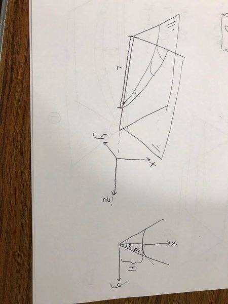

The problem is fluid flowing down a wedge, though I think I understand the scaling, if that's what you're referring to? If ##z## is the direction of flow, ##y## is the coordinate going into the wedge, and ##x## goes from the corner upwards, ##\alpha## the half-corner angle of the wedge, and ##L## a characteristic length (in ##z## direction) and ##H## characteristic height (in ##x## direction) then scales look like
$$z \sim L\\
x \sim H\\
y \sim H\tan\alpha.$$
In this problem the Bond number is very small, and gravity can be neglected. Then Young-Laplace governs pressure (we assume negligible surface stress, since air is above the fluid) and the transverse curvature is assumed much greater than axial, reducing pressure equation to:
$$\Delta P = \sigma\frac{1}{R}\implies\\
P \sim \frac{\sigma}{fH}$$
where ##f = (\cos\theta/\sin\alpha-1)^{-1}## is a geometric function such that ##fH=R## where ##R## is the radius of curvature in the ##x-y## plane and ##\theta## is static contact angle of fluid. Then scaling the ##z## component of Navier Stokes yields to order ##\epsilon \equiv H/L##:
$$P_z = \sin^2\alpha\partial^2_xw+\cos^2\alpha\partial^2_yw.$$
It makes perfect sense to me that the Ohnesorge number emerges with the inertial terms (not included here for simplicity). However, to get a Reynolds number you'd have the Weber number like boneh3ad said. It's just interesting to me that this fluids problem doesn't really require a Reynolds number. What do you both think?

I don't understand your description of the physical problem. Can you please provide a diagram?
Here is a schematic of the flow.
  • Handwritten hand-drawn sketch of a wedge-shaped flow region with a sheet-like plate, coordinate axes labelled x, y and z, a length marked 7 along one edge, and a second smaller wedge sketch with angle labels and an axis labelled x below.
I'm sorry Josh. I can't make sense out of this figure. I'm more confused than ever. Can you please try again?
Here's a sketch I drew a while ago. I probably should've used this earlier. The corner angle measures ##2\alpha## (not shown).
This is much better. As I understand it, you have a trough with liquid flowing down the trough. It is a transient situation, with an advancing wetting front. You are introducing fluid at the left. Does this capture it?
Your understanding is correct! Yes, it's transient, and some of the flows have an advancing front, and others are pinned. I think the scales work out; what do you think? I suppose you could specify a flow-rate condition at a specified height at an end, but I don't think that would change the analysis would it?
