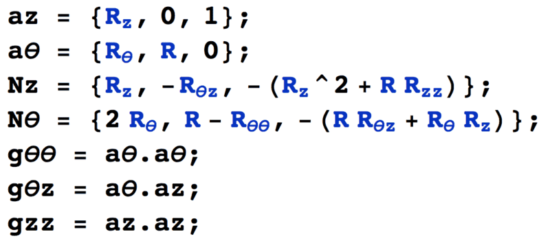

I'll try to write out my result so we can compare.
OK, here's what I got for the pressure (if I did the arithmetic correctly). I corrected the sign error that you pointed out. Please check my results:
$$p=\frac{1}{R\left[1+\left[\frac{\partial R}{\partial z}\right)^2+\left(\frac{1}{R}\frac{\partial R}{\partial \theta}\right)^2\right]^{1/2}}-\frac{\left[1+\left(\frac{1}{R}\frac{\partial R}{\partial \theta}\right)^2\right]\frac{\partial^2 R}{\partial z^2}-2\frac{\partial R}{\partial z}\left(\frac{1}{R}\frac{\partial R}{\partial \theta}\right)\frac{1}{R}\frac{\partial ^2R}{\partial \theta \partial z}+\left[1+\left(\frac{\partial R}{\partial z}\right)\right]^2\frac{1}{R^2}\frac{\partial^2R}{\partial \theta^2}-\frac{1}{R}\left(\frac{1}{R}\frac{\partial R}{\partial \theta}\right)^2}{\left[1+\left[\frac{\partial R}{\partial z}\right)^2+\left(\frac{1}{R}\frac{\partial R}{\partial \theta}\right)^2\right]^{3/2}}$$
Hmmmm I'm not getting exactly this. Did you compute this result in Mathematica? If so I can send you my notebook. I plugged your result and mine in Mathematica and I am not getting zero when fully simplifying the difference of them both.
If you have Mathematica, let me know and I'll send you my notebook. If you don't have Mathematica, can we agree on the following components:
Mathematica code defining az = {Rz, 0, 1}, aθ = {Rθ, R, 0}, Nz = {Rz, -Rθz, -(Rz^2 + R Rzz)}, Nθ = {2 Rθ, R - Rθθ, -(R Rθz + Rθ Rz)}, gθθ = aθ.aθ, gθz = aθ.az, gzz = az.az.
where ##N_z = \partial_z\hat N## and ##N_\theta = \partial_\theta\hat N##. Note vectors are denoted as ##\{a,b,c\} \equiv a\hat r + b\hat \theta + c\hat z##. Everything else is self explanatory I think.
  • Mathematica code defining az = {Rz, 0, 1}, aθ = {Rθ, R, 0}, Nz = {Rz, -Rθz, -(Rz^2 + R Rzz)}, Nθ = {2 Rθ, R - Rθθ, -(R Rθz + Rθ Rz)}, gθθ = aθ.aθ, gθz = aθ.az, gzz = az.az.
If you have Mathematica, let me know and I'll send you my notebook. If you don't have Mathematica, can we agree on the following components:View attachment 220353
I confirm all those components.
