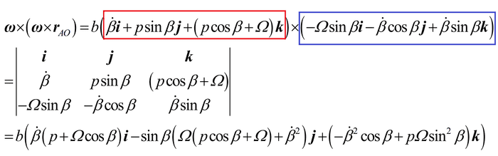

Where did the blue box vector come from in the vector multiplication problem?
The discussion centers on the origin of the blue box vector in the vector multiplication problem related to the equation RAO = b(Sinβj + Cosβk). The user expresses confusion regarding the derivation of this vector, specifically questioning the transition from the red box vector ω to the blue box vector. A participant clarifies that the blue box vector is derived from the calculation of the vector cross product ω × rAO, divided by the scalar factor b, which was omitted in the intermediate steps. This highlights the importance of maintaining clarity in vector operations and scalar factors during calculations.

RAO = b(Sinβj+Cosβk)
[/B]
The box in red is ω. However I am unsure of where they got the box in blue from? As mentioned above, RAO = b(Sinβj+Cosβk) so not sure where they got the box in blue from? I know of the vector triple product: A x (B x C) = (A•C)B - (A.B)C, but this isn't what they've done?

I would assume that they are doing the obvious thing, ie. calculating [itex]\mathbf{\omega} \times \mathbf{r}_{AO}[/itex] first, and given the presence of a scalar factor of [itex]b[/itex] (which goes missing in the second line before reappearing in the third) the vector in the blue box must therefore be [tex]\frac{\mathbf{\omega} \times \mathbf{r}_{AO}}{b}.[/tex] (Although given that something did go missing partway through I would recommend double-checking this.)
