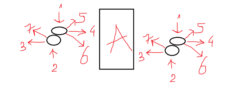

Here is what I got:
when being affected by the the forces come from the weight of the water molecules above them (1 and 2)
1 is the force from gravity pulling the molecules down
2 is created just like the floor when you push a balloon toward the floor. Then the floor will send back the same amount of force ( Newton). Same thing in this case I believe.
When 2 molecules are being forced , they will bounce out in random directions (like 3 -> 6)
then they will crash into the object A . That's how pressure is created.
In deeper level, there will be more pressure due to the increasing of forces number 1 & 2 ( more water molecules are above them equal more weight they have to handle). So those 2 molecules to receive more energy. They will travel even faster and crash harder into the object A create stronger pressure
In conclusion, sea pressure is created due to the water molecules' rapid movement and their impact with the object A.
That's what I got. please feel free to correct me and explain further if I'm wrong. Thank you guys for bearing with me . Thank you again in advance.
