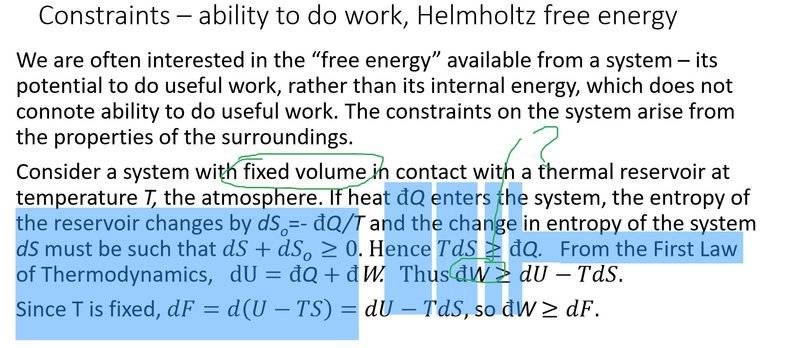

tze liu
57
Sorry,i want to ask a question here
the note said the volume is "fixed" here.
if the volume if fixed,how comes the work done(because no change of volume) here
i totally get lost here
thank

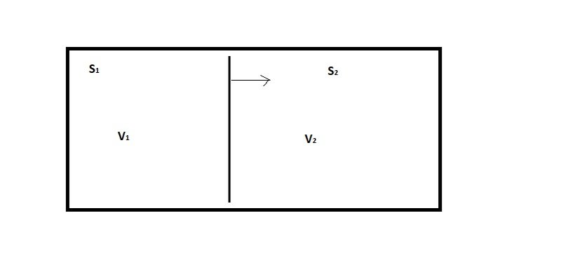

Figure 1: Thermally isolated systems sharing a volume
If system [itex]S_1[/itex] expands by pushing the partition to the right, then it will do work on system [itex]S_2[/itex]. The amount of work done is given by:
[itex]\Delta W = P \Delta V_1[/itex]
We can use the definition of internal energy to relate the work to the heat going in or out:
[itex]\Delta U = \Delta Q - \Delta W = T \Delta S - P \Delta V[/itex]
(Sometimes this is written with a plus sign in front of [itex]\Delta W[/tex], but that depends on whether you're talking about the work done by the system or the work done on the system. If the changes are reversible, as we're assuming, the two are just the negatives of each other).<br /> <br /> If the systems are thermally isolated, then [itex]\Delta Q = T \Delta S = 0[/itex], which means that [itex]\Delta W = - \Delta U[/itex]<br /> <br /> So the work done by the system is just equal to the loss of internal energy of the system. So in this scenario, the internal energy is a measure of the ability of the system to do work. <br /> <br /> <b>Note</b>: The above discussion is for a reversible change. In an irreversible change, the work done by the system can be less than [itex]-\Delta U[/itex]. So we really get:<br /> <br /> [itex]\Delta W \leq - \Delta U[/itex]<br /> <br /> Now, let's relax the constraint that the two systems are thermally isolated, and instead assume that they are free to exchange heat with a surrounding medium, as in Figure 2:<br /> <div class="bbImageWrapper js-lbImage" title="Delta-A.jpg" data-src="https://www.physicsforums.com/attachments/delta-a-jpg.207957/" data-type="image" data-lb-sidebar-href="" data-lb-caption-extra-html="" data-single-image="1" > <img src="https://www.physicsforums.com/attachments/delta-a-jpg.207957/" data-url="" class="bbImage" data-zoom-target="1" style="" alt="Delta-A.jpg" title="Delta-A.jpg" width="800" height="503" loading="lazy" decoding="async" /> </div> <br /> <b>Figure 2: Systems may exchange heat with surrounding medium, but temperature is kept constant<br /> </b><br /> In this case, it's no longer necessarily true that [itex]\Delta Q = 0[/itex] when system 1 expands. As it expands, it can absorb heat from the surrounding heat bath, making [itex]\Delta Q > 0[/itex]. But assuming the heat bath is much larger than either of the two systems, the temperature will remain constant during any reversible change of system 1. So we can use a different thermodynamic identity:<br /> <br /> [itex]\Delta A = \Delta U - \Delta (S T) = - P \Delta V - S \Delta T[/itex]<br /> <br /> In this case, the heat bath is keeping the temperature constant, so [itex]\Delta T = 0[/itex]. So we have:<br /> <br /> [itex]\Delta A = -P \Delta V = -\Delta W[/itex]<br /> <br /> So in this case, it is [itex]A[/itex] that gives a measure of the potential of the system to do work, rather than [itex]U[/itex].<br /> <br /> Again, this is for a reversible change. For an irreversible change, [itex]-\Delta A[/itex] is an upper bound on the amount of work done by the system:<br /> <br /> [itex]\Delta W \leq - \Delta A[/itex]<br /> <br /> The discussion in Wikipedia is misleading, because of course, a system can't do any work if the volume is not allowed to change. I think that the issue is resolved by assuming that there is more than one system involved. The volume of the composite system doesn't change, but the volumes of the smaller subsystems can change, and Helmholtz free energy is a measure of the capacity of the subsystem to do work.[/itex]

You are correct that no P-V work is done. So, if the only focus is P-V work, and the P-V work is zero, then the inequality is satisfied. But there are other kinds of work that can be done on the system (or the system can do on the surroundings), and, if these are operative, then the inequality applies. For a more detailed derivation and description of all this, see Denbigh, Principles of Chemical Equilibrium.
""But there are other kinds of work that can be done on the system""
thank
do u means those work done doesn't change the volume of the system?
thank
Yes

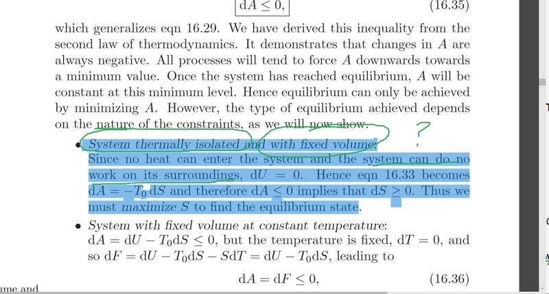

Chestermiller said:
Don't forget also the possibility of electrochemical work like a battery.
is this sentense incorrect?
even that the system is thermal isolated and the volume is fixed
there are STILL SOME electrochemical work or other type of mechanical work here
so the delta U is not zero?
You can have a current-carrying wire coming into the container and another wire exiting the container, with the current driven by a battery situated inside the container (elecrochemical). In this case, the internal energy of the system in the container changes (i.e., the battery is running down). The current can drive a motor outside the container. So the system is doing work.
