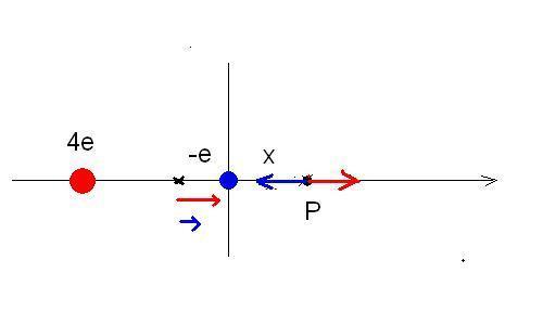

"Where's The Electric Field 0" Problem
I'm given an electron at the origin with charge "e", and an ion (with "+4 e" charge), both on the x axis. The distance between the electron and proton is given as 11 nanometers.
I need to find where the electric field will be equal to 0.
E=kq/(d^2)
So I know that the electric field is 0 where the individual electric fields from the electron and ion cancel each other out (right between them on the x axis).
I set negative kq/(d^2) for the electron equal to positive kq/(d^2) for the ion, so
k(4e)/(d^2) = -k(e)/[(11-d)^2] (please note the negative sign on the right hand side, because my thinking was that this is an opposite electric field, so it should have an opposite sign)
The k's and e's cancel out, but every time after doing the algebra, I simply get a quadratic equation with imaginary solutions.
Any help would really be appreciated.

it will maybe help to draw a picture. put one of the charges at position zero, and label the other charge at position 11, or ##L## to make it neat. and label your 'equilibrium point' at position ##x##. Then, once you decide which charge is the bigger one, it should become more clear what each of the distances are.

You need to take the sign into consideration. And draw a picture showing the direction of the electric field due to both charges. The electric field of the positive charge is repelling, points away from the charge, the field of the negative charge is attracting.
Can the fields cancel between the charges?
