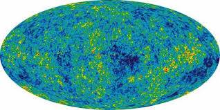

I'm confused by this statement. Which plots are you referring to? The well-known WMAP image of the CMB:
is the real temperature field: it is the sum total (appropriately weighted) of all the multipole moments!

I don't understand why you see it this way. Formally, the temperature fluctuation amplitude is given by
[tex]\frac{\delta T}{T}(n) = \sum_{\ell, m} a_{\ell m}Y_{\ell m}(n)[/tex]
where the [itex]Y_{\ell m}[/itex] are the multipole moments and [itex]n[/itex] is the direction vector. The full WMAP picture is the sum of each of the individual multipole moments, just as a general fluctuation can be Fourier analyzed into its consituent harmonics. Physically, this makes sense: the temperature fluctuation at a given point in the sky is the result of superposition of fluctuations existing across a range of wavelengths.
If we were to remove all the multipoles we'd have nothing left!
