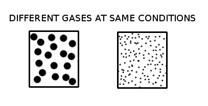

But if a molecule is smaller won't them be more in the same volume like in this picture ?
If the two boxes are at the same temperature, the second one will have a larger pressure. You have to compare them in the same conditions of pressure and temperature. The molar volume (the 22.4 L) is defined in normal conditions (room temperature and atmospheric pressure). If the conditions are different the volume will be different.
Scientifico You might indeed think that more would fit if the molecules were smaller. That's why Avogadro's Law is not trivial or obvious. It might help to consider two points:
(1) The molecules have big empty spaces between them: the molecules aren't elbowing each other apart, as in a solid or liquid.
(2) Note the very specific conditions under which there are equal numbers of different kinds of molecules in the same volume: equal pressure and temperature. It is only by considering in detail what each of these conditions implies (in terms of molecules) that we can really understand how Avogadro's law arises. Again I refer you to the thread "Explaining Avogadro's Law using kinetic theory" (September 4th 2012).
You'd think so... Until you look at the numbers. The size of a gas molecule is something like 10-8 cm (an oxygen or nitrogen molecule is about half that size). So if you have 6x1023 of them, that's a total volume of less than one cubic centimeter. Spread that through 22.4 liters (22,400 cubic centimeters) and you'll see that it's nearly all empty space and the molecules can be thought of as point particles.
