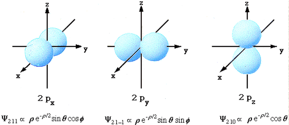

Happiness said:
##p_x## and ##p_y## orbitals have their ##m## negative of each other, implying their ##L_z## are pointing in opposite directions. But I don't see how they are opposite from the diagram. How do you see it?
And the superposition of these 3 orbitals alone, exactly as they are shown in the diagram, doesn't give spherical symmetry right? Because it would give a higher probability along the 3 axes of the coordinate system. To produce spherical symmetry, we have to continue adding more triplets of orbitals (##p_x##, ##p_y## and ##p_z##) whose axes point in all other directions. Right?
No, very obviously adding the squared modulus of the three orbitals you mention above removes any angular dependence.
Just for the record: Where did you get this picture from? It is completely wrong. The px, py and pz orbitals do NOT correspond to m=-1,0 and +1. The following image from wikipedia gives the orbitals corresponding to the different m states:
Note that only the p-orbital for m=0 looks like the ones you posted. So why is that the case? The orbitals are in principle complex functions. The value of the real part is given by the shape, while the colors indicate the imaginary part. As you can see, the m=0 orbital is already real, while the ones for m=-1 and +1 are not. In fact, they have a 2 pi rotation of the phase around the axis. As phase gradients are roughly representing the local wavevector, this is indicative of the orbital angular momentum.
However, in many situations you want real orbitals or ones with a directionality that matches the symmetry of your problem. This is how px, py and pz-orbitals come into play. If you build the two possible superpositions of the m=-1 and m=+1 modes, the corresponding superposition orbitals will be real. And they will look like px and py. These orbitals are great, e.g. for chemistry, where you may have a lattice and bonds predominantly form along the lattice directions. However, they do not represent the orbital angular momentum projections.
The diagram is from the University of Pennsylvania: https://www.sas.upenn.edu/~milester/courses/chem101/AQMChem101/AQMPages/AQMIIIc.html
But since adding square moduli is not a superposition, would you then agree that a superposition of ##p_x##, ##p_y## and ##p_z## will not produce spherical symmetry, unless you also add in those triplets (##p_x##, ##p_y## and ##p_z##) whose longitudinal axes point in other directions?
Happiness said:
Then I would use different resources for learning physics.
The orbitals are orthogonal. If you find that the squared modulus of the sum and the sum of the individual squared moduli differs, your math is erroneous.
