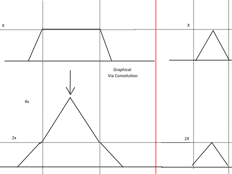

I know you didn't want a mathematical explanation, but if you are familiar with Fourier transforms, that is really the easiest way to explain it. Are you familiar with the differences between the Fourier transforms of a trapezoidal wave (slew-rate-limited square wave) and the transform of an ideal square wave? :smile:

@berkeman: As far as the (Graphical Convolution) responses for a trapezoidal wave and triangle wave (oops after I drew that I noticed you meant square wave, but I know that this is actually a triangle response of the same width time)
I am interested to here more explanation on this now assuming I have my trapezoidal wave convoluted right (it's been a while).

You have some good replies above to your two questions. My point about the difference in spectra between the square wave and a trapezoidal (repeating) waveform is that the energy in the harmonics is reduced for the slew-rate-limited trapezoidal waveform. That is the mathematical explanation behind why slew-rate limiting helps to "reduce noise" -- it is cutting down on the energy in the harmonics of the signal. :smile:
