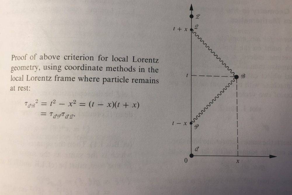

Can someone tell me why the proper time between αβ is not t2+x2 but rather
t2-x2?

Yes but why? Can you derive it?
See any textbook on relativity. They all derive the invariant interval.
Try constructing an inertial coordinate system ##(x’ , t’)## with the following criteria: events A and B both have ##x’_A =x’_B =0##, and the slope of the line connecting P, Q, and the origin in the primed coordinates is equal to ##- x_B / t_B## (in the unprimed coordinates), and the light rays connecting P to B and B to Q keep their slopes of 1 and -1 respectively. When you do this, which of these quantities remains invariant despite using different coordinates: ##t^2 + x^2## and ##t’^2 + x’^2##, or ##t^2 - x^2## and ##t’^2 - x’^2##?

I failed to show it graphically..

Unfortunately the surface of the sheet of paper on which we draw our spacetime diagrams is Euclidean, and that means that the drawing cannot accurately represent distances. These diagrams are enormously useful for showing how different events are related to one another: you can easily pick out the worldlines of objects that are moving inertially so at rest in some inertial frame; if you're careful with your axes you can see which events happen before, after, or at the same time as other events; these diagrams are by far the best way of visualizing the x and t coordinates; you can make sense of the pole-barn paradox, the twin paradox, and many of the other classic paradoxes of special relativity; and they are an essential starting point for general relativity.
But the surface of the paper is still Euclidean not Minkowski, so there's one thing that doesn't work. You cannot plop a ruler down on the surface of the paper and measure the distance between two points. That will give you the Euclidean distance, which isn’t right for spacetime.

You can't. You're drawing your graph on a sheet of paper that obeys Euclidean geometry so the Pythagorean theorem works and the distance between points is given by ##\Delta{s}^2=\Delta{t}^2+\Delta{x}^2## and that's not the right relationship between distance and displacement in Minkowski geometry.
You can use the graph to show the relationship between the various intervals (that's what MTW are doing in the image you posted), but you can't make the distances come out right except in a few special cases (and it would be a good exercise to figure out which these are).

Okay I see now with the help of Minkowski diagram, what I'm seeing is that when a particle is at rest in the primed frame, its ##\Delta t## is exactly the line segment in the unprimed frame given by the Pythagorean theorem ##\Delta x^2 + \Delta t^2## however scaled differently in the primed frame (its value equals to ##\Delta t^2 - \Delta x^2##). So my question now is why and how is ##\Delta t^2 - \Delta x^2## invariant mathematically in the Minkowski space?
Yes, in that case and it also works when ##\Delta{t}## is zero.
Because the x and t coordinates in one frame are related to the x and t coordinates in another frame by the Lorentz transformations. It's just an exercise in algebra (one that you'll find in any relativity textbook) to show that these transformations change x to x' and t to t' in such a way that ##\Delta{t}^2-\Delta{x}^2=\Delta{t'}^2-\Delta{x'}^2##. Thus your question comes down to asking why the Lorentz transformations describe how the universe we live in works (if they didn't we wouldn't care about them or Minkowski space).
