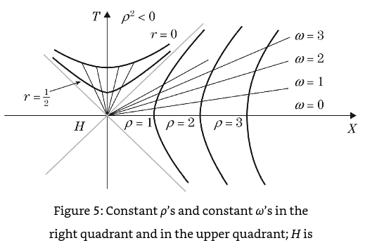

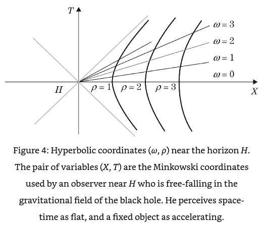

He refers to this figure:
Sagittarius A-Star said:
It depends on, for what the capital letters X, T are used. Maybe that are used for the standard Minkowski coordinates.
There are no Minkowski coordinates on Schwarzschild spacetime (apart from locally) but the coordinates discussed here are explicitly said to be Kruskal–Szekeres coordinates.
Yes, T is definitely not proper time.

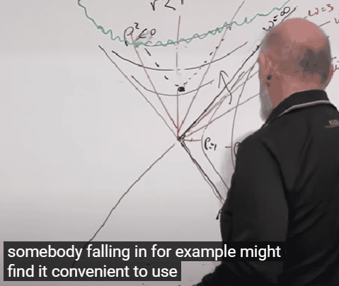

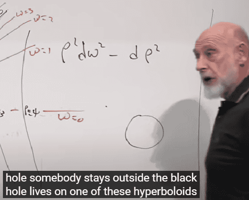

Unfortunately, I don't have the book to check this. I found the opposite statement in his related video at 46:00.
It does not seem opposite to me, but rather the same, although put more mildly:
(the last part said while gesturing to T and X)

The presentation in the book goes like this:
First, using Minkowski coordinates X and T, he develops flat metric in hyperbolic coordinates. Then, using KS coordinates X and T, he approximates Schwarzschild metric in the vicinity of horizon and shows that it is (approximately) the same as the flat metric in the hyperbolic coordinates developed earlier.
Does this process involve a transformation on the KS coordinates that looks like what I described in post #4? It should.
The analogue of hyperbolic coordinates here are of course Schwarzschild coordinates.
Yes, he rescales and offsets.
Yes, they are.
Ok, good. That makes a big difference, and from your earlier posts it was not at all clear that he was doing that.
Yes, that is correct. Sorry, I interpreted wrongly Susskinds first two sentences after 46:00.
However, I can't find in the video the following of what you quoted in the OP from the book:
Hill said:
These are the points in the book:
4. ... T is by definition the proper time of the observer. ...
