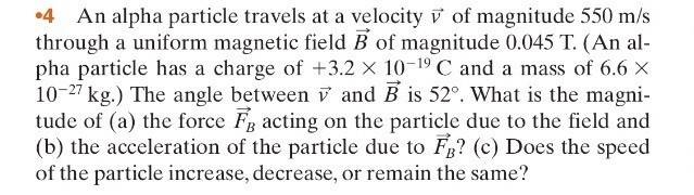

F= qvB sin theta
F=ma
[/B]
A) 6.2x10^18N
B)9.5x10^8m/s^2
C) this is the problem when I searched lot of solutions they say that speed remains the same
Could someone explain this to me[/B]
How is the force direction related to the particle velocity?
Using the right hand rule, v and b are at 52 degrees and the force should be 90 degrees to the velocity. Am I right?
Yes, but what conclusion can you draw from this? (The magnetic force is always at a right angle to both the field and the velocity!)
I don't understand that yet
So let me ask you this: how do you compute the speed?

It's already given in the question 550m/s
Think about a circular motion: The velocity can change in direction but the speed remains the same..

But I think this is what happened
An alpha particle with a velocity of 550m/s goes in a magnetic field in an angle of 52 degrees
So like in the right hand rule the alpha particle is deflected 90 degrees to the field so the acceleration is to change the velocity by changing the direction but the speed remains the same.
If that is right how would I know if the speed did change?
