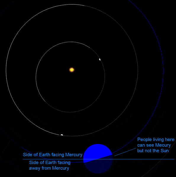

Please if your browser allows use this picture as reference of positions of Earth in relation to Mercury. How can the night side of the Earth shown in the pic ever possibly see Mercury at night up in the sky? http://www.universetoday.com/wp-content/uploads/2013/05/Orrery-view-May27-580x430.jpg
A. That picture is not to scale.
B. Venus is visible, why not Mercury?
C. In that picture Mercury is behind the sun. Suppose it was slightly more counterclockwise in its orbit.

The size of Earth is exaggerated here. This image shows the Sun, orbit of Mercury, orbit of Venus, and the orbit of Earth in June 2015, when Mercury was near maximum elongation. It appeared as a morning star shortly before sunrise.

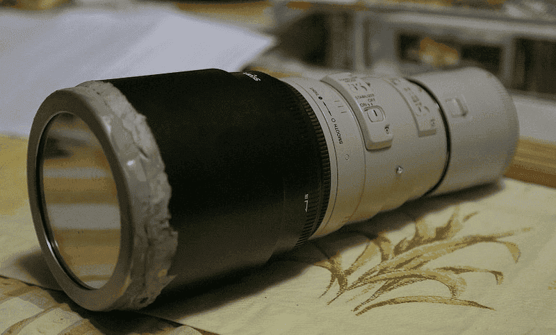

Is this a real unedited photo of the Sun? This is not what I see when I view the Sun. What brand of filters and program do you use?
yes a real unedited pic other than a tiny bit of sharpening. There is a solar filter across the front of the lens, all it does is cut out
99.9% of the light intensity
Dave
