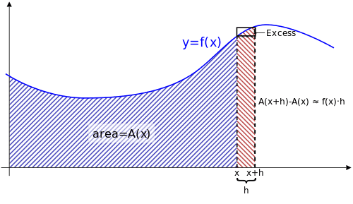

Consider the following graph:
Let [itex]A(x)[/itex] be the area from 0 to x under the graph. The value [itex]A(x+h)-A(x)[/itex] is given by the red piece in the graph. If h is small, then we can approximate it by a small rectangle. The rectangle has sides h and f(x). So A(x+h) is the area up to x+h is given by the area up to x plus the rectangle. So [itex]A(x+h)\sim A(x) + f(x)h[/itex]. This gives us that the rate of change of A is given by [itex]\frac{A(x+h)-A(x)}{h}\sim f(x)[/itex]. So if h is small, then the rate of change of A is f(x). This is an (informal) explanation of why the connection works.
