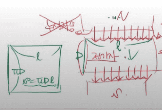

V=P*Z*Phi*N/60a
Induced voltage of DC motor isV=Blv where B= phi/S
where S=2*pi*r*l and magnetic flux is phi=B*2*pi*r*l as shown in the picture.
that leads to the equation V=PZ*phi*N/60amy question is, why do we set S=2*pi*r*l
Shouldn't magnetic flux 0 because the magnetic flux of a closed surface is 0 according to Maxwell's equation.
Could someone please tell me why S=2*pi*r*l
That is zero for the closed surface of a 3D volume. It is not true for the area of a rotating coil.
The induced voltage is the rate of change of flux through the coil.
2⋅π⋅n / 60 ; converts n RPM to angular velocity in radians per second.
You need to define your variables; S, r, l, P, Z, n, a;
Thanks, I figured it out.
