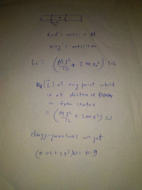

@haruspex, I have added the explanation of this equation in this attachment.
Ok, thanks.
Your error is that you forgot to square the 0.9.

Divya said:
##(0.01+2x^2) \omega =0.9##
So, ##v^2/2=\int_{0.1}^{0.2} \frac {0.9xdx} {(0.01+2x^2)^2}=5##.
## \omega =\frac {0.9}{0.01+2x^2}##
## \omega ^2=\frac {0.9^2}{(0.01+2x^2)^2}##
