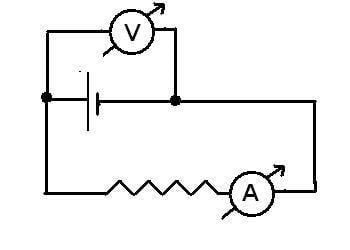

Never connect an ammeter directly across a voltage source. Ammeters are designed to measure current flowing through an element, resistor for example. For that, you have to connect it in series with the element.
Voltmeters measure voltage across an element, for that you need to connect it parallel with the element.
ehild

An ammeter appears as a short circuit from its input lead to its output lead. It's purpose is to measure the current passing through it as if it was not there. All ammeters have some very small resistance, and so cause some voltage drop. (That is a basic "instrumentation problem").
A voltmeter appears as a open circuit between its leads. It's purpose is to tell you the voltage without drawing current. All voltameters draw some small amount of current. (That is another "instrumentation problem").
So, if you connect an ammeter across a battery, you have essentially shorted the battery and a huge current will flow.
