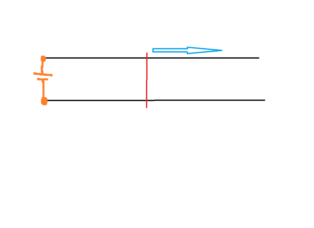

Let me give this one specific example of the homopolar aka Faraday linear motor. Which we know as two conducting rails on which a perpendicular conducting rod is placed, then a DC potential is attached between both of the rails, the rod starts moving forward or backward depending on polarity.
I made a drawing of this model in the attached picture.
Now to make this clear at least for me I want to ask , assume the DC potential is capable of unlimited current and there is no voltage drop, also the rails and the rod that connects them have 0 resistance and the rails strecth away for as long as needed. So if there is no resistive voltage drop and no current/voltage limitation from the power source , when the rod has moved away from the power source for a considerable length is the current through the loop still the same as at start when the rod was right at the power source?
For a real world situation the further the rod moves the higher the resistance becomes and current decreases , but what happens in my example?

Ibix said:
the wire's protons (and their charge) are crossing the surface too, and this is being forgotten
That is only true during a change in PD across the conductor when the lattice distorts slightly. But the mass of the nucleus, relative to its free electron, is huge so the displacement will be negligible. I have proposed (but not carried out) an experiment with a tray of mercury, carrying a hefty current in which the force on the nuclei should cause the liquid to lean towards the negative end of the tray. I would expect this to be a very small slope but it could be magnified using AC of an appropriate frequency to build up a longitudinal wave in the liquid. (A Q factor of several tens would be reasonable, I guess)
It is probably not valid to impose conditions like that. It's very likely that the Energy that is put into the motion of the rod, appears as a Resistance like the Radiation Resistance that's measured at the feed point of a radiating RF antenna.

I was talking about the rest frame of the electrons drifting along the wire. In this case the electrons are stationary and the protons are moving. In fact, the movement of protons is the source of the current in this frame.
Is there a lot of point in the 'frame game' here? The electrons have a range of velocities extending to fractions of c, I believe. The actual drift velocity of electrons in a circuit, once the current is known, will vary with the thickness of the wire (remember that horrid water analogy?). Any analysis like the one you suggest would have to deal with that - or to assume that the wire gauge was uniform. It seems a very hard way of looking at things.
