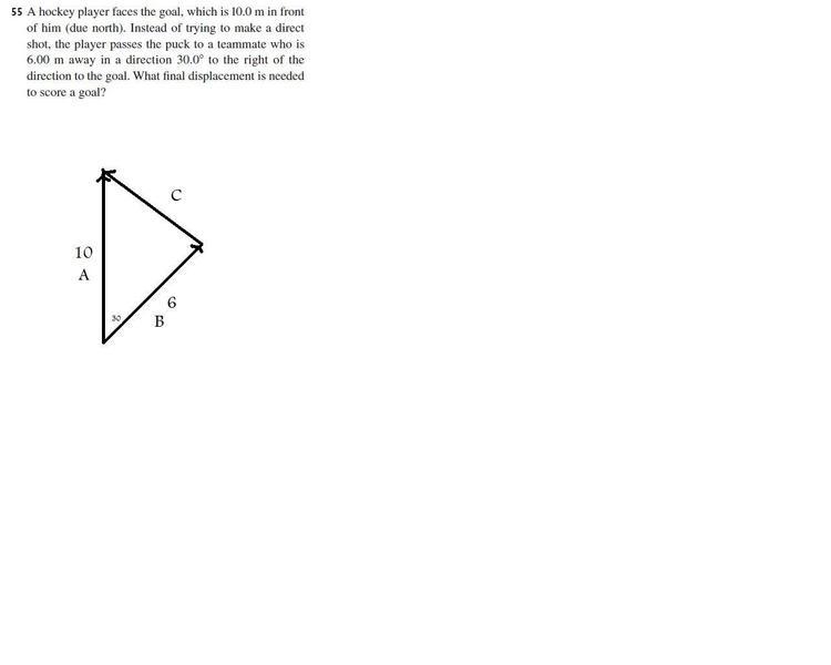

Posted a picture... the picture consists of the word problem and the triangle is how I interpreted the problem...
Vector A Components: (0,10)
Vector B Components: ( Cos60*6,Sin60*6)
Vector C Components: (Cos60*6 = 3 , Sin60*6 + 10 = 15) ... ( 3 , 15 )
Vector C = (9 + 225) ^(1/2) = 15
The true answer is 5.66...
What did I do wrong?
Correct up until here.
You want to find vector C such that B+C = A. Do you understand why?
Also you should note that the questions asks for the final displacement, which is a vector, not a scalar.
Would the resultant vector be A at (0,10) because that is where the final position lies?
Yes, but you want to find C
