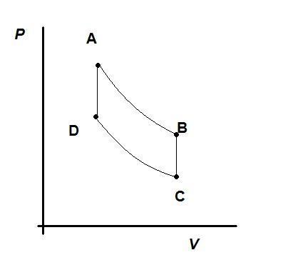

At point D: P=2atm, T=360K, n=2mol
At point B: V=3VD, P=2Pc
Paths AB and CD represent isothermal processes
The gas is carried through a complete cycle along the path DABCD. Determine the total amount of work done by the gas.
PV=nRT
W=nRT*ln(V2/V1) (by integration)
I only need the work for the two curved sections (because the work by the vertical ones is zero). Using a system of equations, I determined the following (in the form PV=nRT):
A: Pa*29.6=2*R*721
B: (4/3)*88.8=2*R*721
C: (2/3)*88.8=2*R*360
D: 2*29.6=2*R*360
Using the work equation, I get Wab=-130J and Wcd=64.9J
But the solutions in my book say I should have -13.2kJ and 6.58kJ, respctively
I am pretty sure I solved for the variables correctly; am I not using the correct formula to find work? Or is there something I've missed...

Perhaps I'm misunderstanding the problem, but isn't work done = ∫PdV, the area inside the graph? :confused:
yes, but I don't have any of the equations for the lines on the graph.
using the energy equation (E=Qin+W). for an isothermal process E=0, so Qin=-W, and W=PdV=∫(nRT)/V*dV=nRT*ln(V2/V1)
actually--i just redid the problem, it turns out i was using the wrong gas constant R...
But you are given the width and height of the region as proportions of the (x,y) coordinates of D. :wink:
(and, assuming AB and DC are meant to be "parallel", the area is width times height)
