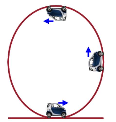

Hippo89
Whats’s the minimum speed so that car stays in contact with the top of a vertical loop? R = 9.7 m, mass of car = 257 kg
Fc = MAc
I got the answer right, but it involved some guessing. So I’m here to make sure I got a conceptual understanding of this.
Normal force is a contact force. If the car was not in contact with the loop (or barely in contact), the loop would exert no normal force on the car. So at the minimum speed, the car would have minimum contact with the loop at the top, meaning that the loop would exert 0 Normal force on The car At the top.
Fcar, top = MAc = W = MG. Ac = G. 9.8 = (min speed)^2/9.7.
Vmin = 9.75 m/s for the car to keep in contact with loop of R = 9.7 m.

Side note: You should be worried about the minimum speed needed at the bottom of the loop if the fictious car were going to have a chance at making the loop.

I am not saying that your solution is wrong, but here you wondering if it is right. The way to do it convincingly "right" is to write Newton's second law equation in the general case where the normal force ##N## is not zero. Then set ##N=0## in that equation and see what you get for the speed. Follow this procedure for this particular problem and you will see why your answer came out right.
