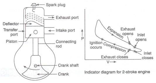

Would two stroke spark ignition PV digram be same as 4 stroke spark ignition. both have otto pv diagrams.

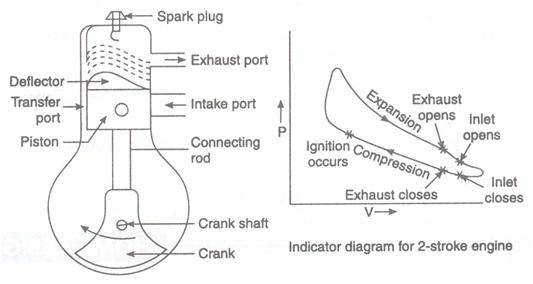

There are no 0 to 1 nor 5 to 0 lines drawn on the PV diagram. That is the difference between the 2-stroke and the 4-stroke PV diagrams. The 2-stroke has only 4 points:
Both the intake & exhaust phases will begin somewhere between 3 and 4 and end somewhere between 1 and 2.

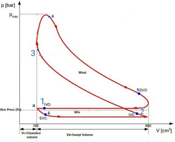

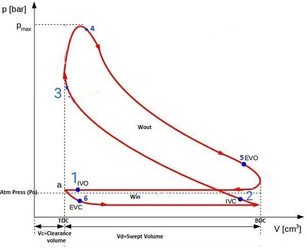

Versus a 4-stroke engine PV diagram:
Pressure-volume diagram of a four-stroke engine cycle with points 1 to 6 marked, pressure p [bar] against volume V [cm3], showing IVO, EVO, IVC, EVC, TDC and BDC.

If you look at the 4-stroke engine PV diagram in my last post, a downward stroke is from TDC (top dead center) to BDC (bottom dead center) and an upward stroke is from BDC to TDC. The same limits applied to a 2-stroke engine.
