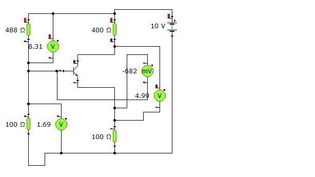

FIRST
is this formula OK
for example rc=(3.600X10000)/(3600+10000)=2650
desired voltage 0.5, 2650/0.5=5300 so re=5300
voltage gain is 2650/5300=0.5
is this correct formula? if is this is correct formula why my simulator is 43mV not 50mv
where is wrong my formula of my simulator? can you exaplian me please thanx

Show as a diagram and all components values.
And tell as how long you have been learn electronics?

long enough,
rc=3.600
rl=10000
re bypass 5300, only 1 resistor in parallel with capacitor
voltage divider
r1=10000
r2 = 2.200
power supply 10v
input voltage 2mv at frequnecy 20K
  • #32
If I understand you correctly your circuit look like this:
and Vcc = 10V
If so the collector current is equal to
Ic ≈ Ve/RE ≈ 1.1V/5.3KΩ ≈ 0.2mA
and Vc = Vcc - Ic *Rc = 10V - 0.2mA * 3.6K = 10V - 0.72V = 9.28V .
And the voltage gain
Av = (Rc||RL)/re = 2.65KΩ/130Ω = 20[V/V]
And
Vout = 20* Vin = 20 * 2mV = 40mV
But your amplifier Q point (bias point) was not chosen properly.
See this post
https://www.physicsforums.com/showthread.php?p=4058469#post4058469
Where
re = 26mV/Ic
Ve = (Vcc* R2/(R1+R2)) - Vbe

sorry i am a beginner
my circuits look like that,
but when you start to build an amplifier, which are the first steps to take
and how to get a desired voltage,
i so my amplifier is bad, but is was good the re was 1k but me i changet to experiment to get desired voltage
what do you think, do you have time to build one amplifier with desired gain, can you show step by step and to explain in similary way please

do you see
vcc 10V
collector 10
IC 10ma
Vce midpoint
Bdc 100
now what to do, how to find desired gain

Thats not exactly what I had in mind but it is a start. I think if you actually knew how to get those resistor values and voltages you would not need to ask how to figure the gain. Did you plug some numbers into a simulator or something to get this? I mentioned to you that we would put the collector voltage at 5 volts. You have it at 6 volts which is close enough. AC voltage gain of this amplifier is 4 UNLOADED. How can you not know that? You have previously posted that you know the formula for gain which is (RL ||RC)/RE. Zout of this amplifier is 400 ohms.
Next. Zin. Originally you wanted a Zin of 50K. Do you see how that is next to impossible with transistor betas typically around 100 using components you have selected?

Let me ask you this michael: How did you select the resistors in the schematic that you posted in post #42?
  • #48
When we start design any circuit we need to know circuit specification.
If you have a 2mV input voltage and 100mV at output you need a amplifier with gain
Av = 100mV/2mV = 50[V/V] and Zin = 50K and Rload >2K.
i think first i select voltage divider, and after rc and re
