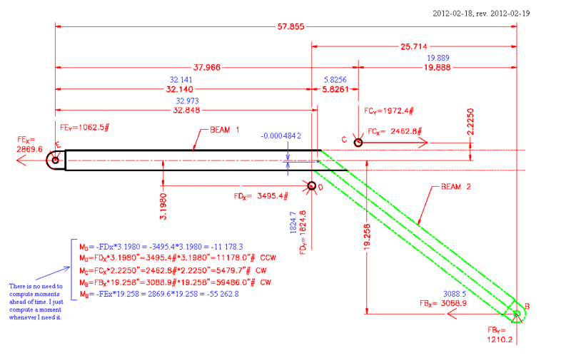

Ok,
On the attached I have rotated the structure and it's forces so beam 1 is horizontal. I then made a chart to break these forces down in there horizontal x, and vertical y components.
I then added the horizontal x, and vertical y components respectively per the pins they are acting on.
When I did my shear diagram, none of my forces have crossed the zero line, nor did they balance out to zero.
Were did I go wrong?
Thank you
grandnat_6: Your solution in post 12 is currently incorrect at points B and E, as follows. You have the wrong sign (wrong direction) on FBy. And you erroneously ignored the negative sign on FEx in my post 9 attached file. Try again.
I found out what was wrong with the diagram in post 9. The math shows it's a negative force but the arrow head on the vector is facing positive. I have corrected this on my armvectorforces.pdf. I must have forgotten about the negative number since the vector was going positive.
The shear force and bending moment diagram. I plotted them out in shear_momentforces.pdf. I know the shear part is correct now because the addition equals zero, so it is balanced. The moment diagram I am unsure if it is correct. shouldn't I be going from the 26842.3"# directly to zero instead of 52377.1"#?
Since my shear force diagram passes though the zero line twice the maxium moment should be either of those two figures, and should be 29838.6"#'s since it is the largest number, if 52377.1"#'s is not correct.
Thank you.

grandnat_6: First, just a minor comment.
If you draw a vector pointing toward the left, and the force points to the left, then the vector magnitude is positive, not negative; but its direction is negative. Likewise, if you draw a vector pointing downward, and the force is downward, then the vector magnitude is positive, not negative; but its direction is negative.
Conversely, if you draw a vector pointing toward the right, and the force points to the left, then the vector magnitude is negative.
In other words, because four vectors in your shear_momentforces.pdf file are drawn in the negative direction, then you should not put a negative sign on their magnitude. Remove the negative sign. You already know they are negative forces, because the vector is drawn in the negative direction.​
Your shear force diagram currently appears correct. Nice work. Your bending moment diagram is correct from point E to D, but is currently incorrect from point D to C to B, because you did not include the moment of any horizontal force that is not on the same y coordinate as the location you are summing moments about. Try again.

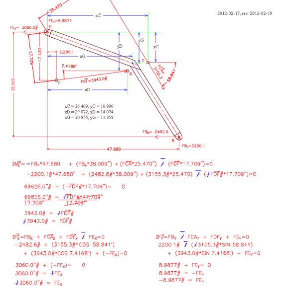

I have attached my new work. Please note dimensions have changed. I got up to the same point we left off. My moment diagram did not seem correct again because it does not return to zero. I did some reading in my statics book, I have not read it in the book, but I think it is probably correct since pin E and D are basicly holding the beam and the forces on pin B act as a cantiliver. My book does not show an example of a couple and a force acting on the same point, but I have noticed if I add the force of the couple of 65200.00"# acting on pin B to my maximium moment of -65193, I'm within 7lbs.
My book says not to add the force going though the distance you are taking moments from, but does not say anything about a couple. So I'd assume the couple does not get added either?
Thanks.

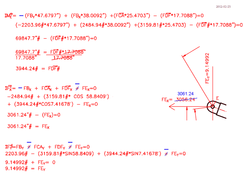

grandnat_6: First, I have a question about dimensions. Please provide dimensions a1, a2, and a3, highlighted in blue, in the attached file. Dimension a1 is at the exact intersection of the centerlines of beam 1 and beam 2.
By the way, this time, your file is blurry, and I am having trouble reading some of your numbers. Also, if you can, try to save your files using only 16 colors, not millions of colors.
I thought you would want to add 60 % of the weight of your hydraulic cylinders and beams to the vertical load applied to your bucket tip. Did you decide not to?
Your first calculation is wrong. I marked it in the attached file. Not only did you make a mistake calculating the final Fa answer, you also forgot to include the y component of Fa in your Mb moment summation (because Fay is offset horizontally from point B). I stopped checking here, because this will make all of your subsequent calculations wrong. Try again.

I don't know why it was blurry. All I do is select DWG to PDF for the printer. As far as colors I do not know how to change that. I only use 5 colors in CAD. Sorry for the inconvenience.
I could not read your blue text either. Do you mean I forgot the force of FBy and not FAy?
I have added the other 3 dimensions asked for in the attachments.
I forgot to mention, I left the 500lbs acting on the bucket. Loader buckets that were made for this tractor, the literature says it can lift 350lbs. Adding another 100lbs for the bucket and 60% of the weight for the rams brings it to 478.84lbs. So I left it 500lbs because the oil in the cylinders will add weight and also some of the hydraulic lines. Reasonable?
Thanks.
grandnat_6: What do you mean you could not read my blue text? Can you not zoom in? Was that blue color faded, or what? If you cannot read my shade of blue text, what color do you want me to use for my mark-up? Black, or dark blue, or what?
No, in your first file in post 24, when summing moments about point B, you forgot to include the moment about point B caused by FAy. As shown in my post 23 file, when you do this, you will obtain FA = 3155.30 lbf.

I worked on trying to get the FA=3155.30lbf. I could not get it. I knew in the back of my mind since pin A is not in line with pin B it probably would not be worked the same. I think the problem is in finding FAy. The only thing that makes sense to me is to take the moment of 500lbs*20.563" and then divide by the distance of .57" = 18038.0lbs
I then took that and added it to my 13681.5lbsf obtained in my original problem. Then dividing by 7.4375" to obtain 4264.8lbsf. finally dividing 4264.8lbf by the cos of 58.841 which equals 8242.5lbf.
Please take the time to mark up my bucket forces in post 24.
Thank you.

nvn, Thanks for telling me what FA is. I think I figured it out in the attached bucket forces.pdf.
Re-cap, Since the pins of A and B are in line on the first bucket, the force going though pin A in the Y direction does not produce a moment because the force goes though pin B and you can not use a force going though a point you are summing moments from. Thus pin b in the X direction can, so all the forces acting on it must go through the X direction to be balanced reaction force.
On the second bucket since pin A is offset from pin B in both the X and Y direction a moment is produced in both X and Y of pin B. Since FA has two directions they must be included.
I do have a few questions about this.
What happens if the bucket was pined to a wall by pins A and B in both situations? Is there only an X directed force in both cases on pin B or will the reacting forces be the same as in our first and second bucket analysis? Are there any rules to follow when doing this?
The equation in black on the bucket forces pdf; what is the rule to cancel out the X, and Y to obtain FA? I mean, FAx and FAy are the same forces but they are in different directions so how does the X and Y cancel out?
I also attached my arm forces. I am hoping for a good report.
Thank you.
  • #31
grandnat_6: I do not yet see attachments in post 30. You can hit the Edit button on post 30, to make corrections, if you wish.
Regarding your question, I show you how to perform the calculation with FAx and FAy in my analysis05.png file in post 27.
If the bucket were pinned to a wall (with no roller support), the analysis would be different (because the constraints are different); and therefore, the pin A and B forces would be different. There would be x and y reaction forces at pin A and pin B, which would be four unknowns, which is statically indeterminate (potentially very difficult problem to solve; don't go there).

grandnat_6: By the way, numbers less than 1 must always have a zero before the decimal point. E.g., 0.57, not .57. See the international standard[/color] (ISO 31-0[/color]); or see any credible textbook.
Regarding your question in post 30, the black equation is incorrect. It should not have x and y subscripts. See the blue text in my analysis06.png file to see why, and to see the correct algebra.
All answers in both attached files currently appear to be correct.
Could you also provide dimensions xC, yC, xD, yD, xG, and yG, shown in the attached file? You can just list them; you do not necessarily need to draw them again.

I have attached beam 2 vector analysis and beam2 shear_momentforces.
Since we need to use six significant digits, I choose to change the numbers you provided and move on. I believe my shear diagram is good, but is off slightly because of the signifiant digits. I also tried to follow your math for the moment diagram. I am not quite sure, if we are taking moments around D; are figuring for two separate moments for D? It appears, (because of the significant digit error) that maybe you are summing only the forces to the left in one equation and then plotting it. Then you are slightly moving to the right of D by .0001 and then summing again including the force and moment in D?
If you don't mind, and you have the exact numbers, could you please complete and show me how you figured out the maximium moment like in analysis10.png? This way we can use the numbers in the future. I would like to move forward and start analysising a new position where pins E and B are in the same horizontal plan with the bucket tipped so the bottom side is horizontal with the plane of pins E and B. I think this should be the next step. I'll use six significant digits both for force and dimensions from this point on.
Let me know what you think about this.

I've also looked over your moment diagram and calulations for beam 1 for a fifth time. I went ahead and attempted to calculate beam2. I think I have it, just that the slight differences in our dimensions might have to do with it.
I am also assuming in your moment calcuations the + sign means you are adding the moments produced in the Y direction?
On your moment calcuation of M57.855; why the reason for subtracting 19.258"-3.1980" for the moment? Also, why is the force of FEx being calcuated as a moment? How I understand it, we are checking for beam one, every dimension and force is being calcuated from the centerline of the beam. Since FEx is acting on the center line, how it is producing a force on beam 1. I must be missing something...?:confused:
Thanks.

Regarding your questions in post 38, the plus (+) sign means, it is a moment summation at an infinitesimal distance to the right of the specified x coordinate. Regarding your second question, moments are computed from the centerline of beam 1, until we get to beam 2. Then moments are computed from the centerline of beam 2. The vertical distance from point B to FEx is 19.258. The vertical distance from point B to FDx is (19.258 - 3.1980).

Attached are my new bucket and arm calculations. I did use six significant figures. I noticed on the bucket after I was done finding all forces, there is an error of .003 in the Y direction. After finding all the forces on the arm. The numbers match perfectly.

grandnat_6: After you obtain answers, you can check your work, yourself, by summing forces and moments, to ensure they balance to approximately zero. Your bucketforces.pdf file in post 44 looks correct. In your armforces.pdf file, 70 037.8 is wrong. If you try a moment summation check using your answers in armforces.pdf, you will see the moments do not balance to zero. The 70 037.8 is wrong. Try again.
  • #46
nvn,
I did check the forces in the x and y to make sure they were balanced. I even checked those calculations 3 times! err... Figures, I went back to check and get a different answer right off the bat. Maybe I'm working to hard...
Anyway. I have attached the fix, I also attached my vectorforces for rotated beams and the shear moment diagram. The moment diagram is about 7lbs short. I hope it is not wrong.

grandnat_6: Corrections to your armforces.pdf file are highlighted in blue in armforces12.png, attached below. Study this file, so you will understand the mistake you are making with minus signs. Remember this important rule.
If a vector is drawn in the negative direction (or would cause a negative moment), then the term is preceded by a minus sign in the summation general equation.[/color]​
I made a mistake in a moment diagram calculation in a previous file, so I corrected my mistake in http://img12.imageshack.us/img12/7648/shearmomentforces12.png . Because moments are computed from the centerline of beam 2, the moment must be computed about point I, as shown in the file.
Due to round-off error, the moment balance is off by -3.49, which is close enough and good.

I think I understand what is going on with the moments. Since point G is the intersection of beam 1 and beam 2; anything from the right of point G has to be for beam 2. Likewise anything to the left of point G has to for beam1. Correct? If so, what happens if point C or D lands on intersection G? I'd assume it would work in with and be calculated for both beams?
I take it then our maximium moment for beam 1 is 45,350.3"# and beam two is 38,443.2"#?
