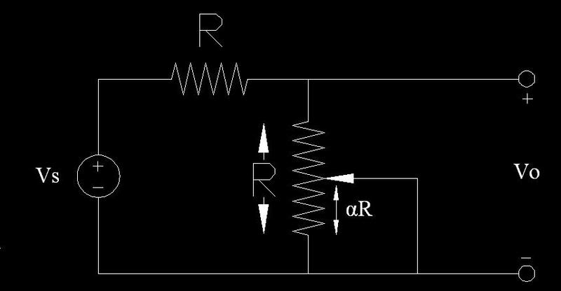

In the circuit below, the wiper divides the potentiometer resistance between \alpha R and\ (1- alpha R), 0 \leq\alpha \geq 1. Find Vo / Vs
KVL
KCL
Im thinking that the Pot. Resistance will be R +(1-\alpha)R. Then to find the voltage (R +(1-\alpha)R)I
You can ignore the resistance of the main part of the pot to ground that is below the wiper because it is in parallel with a short circuit.
The resitance of the pot is simply, R - alphaR = R(1-alpha)
So would the answer be:
((\SigmaR)/I)Vs
Sorry about the formatting, I need to learn how to use the system.
Thanks
Andrew
