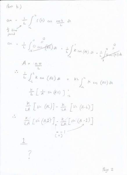

Can someone please help me with a Fourier series equation for a even square wave shown below:
F(t) = 0 when -2ms <t < -1ms
k when -1ms <t < 1ms
0 when 1ms <t < 2ms T=4
Im after finding the first 10 harmonic components. To be honest struggling with this one integration is not my strong point.
Show us some work and what integral you are stuck on.
Hello, sorry for the late reply. I believe I have succesfully found Ao in my equation but An I am struggling with. I have attached my workings out if you may take a look it would be much appreciated.
