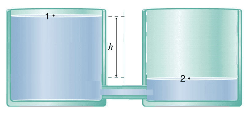

Consider two cylindrical containers of the same diameter. Fill them with a liquid to different levels. We all know that the liquid can be "siphoned" from one container to the other using a thin hose, which we will consider to be thin and of uniform diameter.
Bernoulli's Equation can be used to derive the flow rate (which is essentially the same as Torricelli's Theorem).
However, consider applying Bernoulli's Equation to the free surface of each container.
P1 + pgh1 + 1/2 p v1^2 = P2 + pgh2 + 1/2 p v2^2
Because the cylinders have the same diameter, v1 = v2.
Because a free surface is at atmospheric pressure, P1 = P2.
Bernoulli's Equation then reduces to h1 = h2, which makes no sense.
Does anyone have any insight to why Bernoulli's Equation does not work in this case?

In the diagram attached, Bernoulli's Equation applied to points 1 and 2 gives h = 0, which makes no sense.

That is not a syphon, that is two vessels connected by a pipe at the bottom.
Look at my diagram and think about the value of velocity at A

I'm familiar with your analysis. My question is why does applying Bernoulli's Equation at points 1 and 2 in my diagram give h = 0. Applying Bernoulli's Equation in this way yields the same result whether it's a siphon, or if the vessels are connected by a pipe at the bottom.

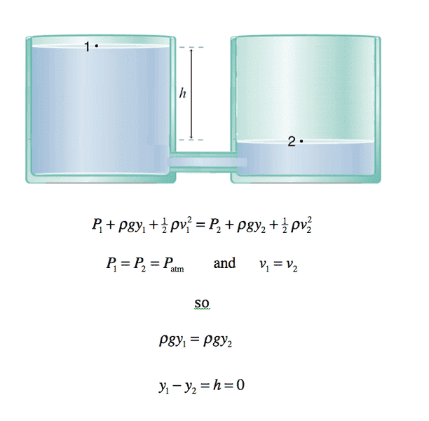

One last time, yes it does.
See image.

Here's the thing: it should predict zero velocity. By applying Bernoulli's equation at the two free surfaces, you are basically asking the equation to predict any motion that would occur directly between two surfaces at the exact same hydrostatic conditions. Of course it will predict no flow. If you ignore the atmospheric pressure, there is no head between the two surfaces.
The problem is that your fluid motion is occurring at the bottom of the tank. What you need to do is relate the pressure at one end of the connecting pipe to the height of the water in that tank and then do the same with the other tank. Then you have a pressure differential and can determine the flow rate. The surfaces will certainly move at the same speed since one is losing liquid at the same rate the other is gaining it and the tanks are identical. Keep in mind that the flow rate will change depending on the height, so a differential equation would need to be solved to get the time history of the heights of the surfaces (or the flow rates).

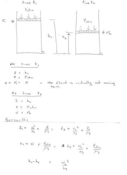

I have drawn just the full vessel at two times.
At t1 just as the emptying process begins and again at t2 when the top parcel of fluid has traveled some distance down the vessel.
At t1 it is important to realize that the velocity is zero. Thus v1 = 0
I have filled in the other conditions for the Bernoulli equation.
At t2 the same parcel of fluid has now lost some potential energy but gained some kinetic energy. The pressure energy has not altered and is still atmospheric. Consequently it is now traveling with velocity v2
Finally I have substituted into the Bernoulli equation which leads to the conclusion that the loss of head (h1 - h2) supplies the energy to drive the fluid at velocity v2.
Can you see this ?

I don't need to ask because I understand how you arrive at each of your equations. The v = sqrt (2gh) result is standard, and I've derived it many times on my own.
Studiot said:
Can you see this ?
Yes, and now you're applying Bernoulli's equation to the same free surface at two different times, with the result that the free surface is moving with a speed v = sqrt (2gh), which is wrong.
I'm happy to be engaged by you, and I thank you for it, but clearly we're going around in circles here.
Please explain.
Of course that still won't give you the answer you want. It doesn't take into account the water moving through the pipe and the influence of the pressure on the other side. What you really need is to know the pressure at each end of the connecting pipe (in this case, hydrostatic pressure) and then the size of the pipe so you can tell what the flow rate through the pipe will be.

Your notes suggest that you think that a free surface that has descended a height h is moving at a speed √2gh.
First, thank you for understanding my question, bone3ead!
Most texts say that Bernoulli's Equation applies to any two points along a streamline. Is there no streamline that can be traced from the free surface on one side to that on the other? And if there is (which I believe is the case) then why does Bernoulli's Equation fail in this case?
The motion is occurring everywhere. The left surface is moving down and the right up.

You are using 2 separate datums, which is why this is not the way to apply Bernoulli.
Using a datum level as the surface of liquid 2:
v1 = -v2
P2 = 0
h2 =0
the equation reduces to
P1 + pgh1 + 1/2 p v1^2 = 0 + 0 + 1/2 p v2^2
And 1/2 p v1^2 = 1/2 p v2^2
So P1 = pgh1
  • #33
I am sure you could find a streamline somewhere that would connect two points such as those you are using, but in reality, if the tank is much larger than the pipe connecting the two, most of the motion will be in the region of the pipe. At any rate, the entire problem is unsteady, so Bernoulli's equation doesn't really apply. There is an unsteady analog to Bernoulli's equation, but then you get significantly more complicated. There are much easier ways to analyze the flow than in that case.
The solution is to say that the surfaces aren't changing much (i.e. D >> d from my previous post) and approximate the situation as steady. Again, it is only an approximation though.
tjm2444 said:
But aren't you saying here that the pressure in the pipe is simply the hydrostatic pressure? Is the water moving at point 2? If so, then the pressure at 2 is lower than the hydrostatic pressure.
The static pressure at one opening is the hydrostatic pressure from that tank and the static pressure at the other opening is the hydrostatic pressure from the height of the water in that tank.
The pressure at point 2 is zero (gauge). There is no pressure other than atmospheric at that point. Same with point 1. The potential energy then that leads to the motion between tanks is gravitational in nature and the flow rate between the two (and thus velocity of the surfaces) is tied to the height difference. However, it is between the inlet and outlet of the pipe that you really need to apply Bernoulli's equation to get your estimate. Picking two points at each surface loses any information about what occurs between them because both points are essentially in equilibrium.
  • #34
So P1 = pgh1
That's an interesting assertion for a free surface of a liquid.
Would you like to explain it?
  • #35
P1 is the pressure of the liquid in container 1 at the same level as the surface of container 2.
P1 is NOT the pressure of the free surface of container 1 which is causing the confusion here.
The energy level at the two free surfaces 1 and 2 are of course not going to be equal.
By how much - by the value P1 = pgh1.
