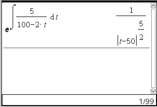

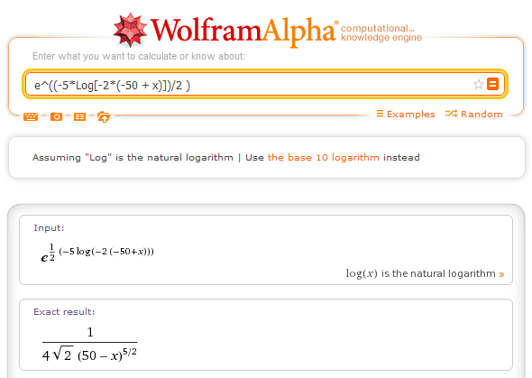

I'm getting different answers for this integral
Are you able to check which one is right by hand?
I don't trust it by hand.
It looks like this one is right:
I have a hard time finding why you expect both TI and WA input to be equivalent.
There should only be one correct answer and several ways to write it. In this case, the answers are different, not just written differently. One is right, and the others are wrong. I'm trying to verify which one is truly correct.

To conclude, it appears that the image below is the correct answer + c. I don't know what wolfram alpha is doing..

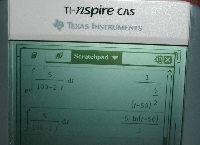

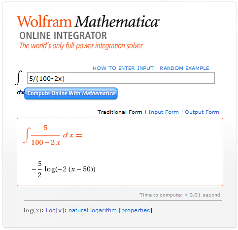

I don't know about "mistake", but WA seems to be wrong. I'll do it again and post the images.
now, +c wasn't added to the first part of this 2 step process. I just took the answer wolfram gave, set it as a power of e, and let wolfram simplify it. Even so, the answer in the first step is wrong/different from what I get from the Ti-nSpire. I get -5/2*ln(x-50)
Hmm, I see: http://www.wolframalpha.com/input/?i=e^%28int+5%2F%28100+-+2t%29+dt+%29

yep, that's essentially what I got from WA earlier. It's still different from the Ti's answer. As I've been saying since the beginning, they can't both be right.

OK, but the two answers are equal up to a constant:
\frac{-5}{2}\log(-2(x-50)) = \frac{-5}{2}\log(2) + \frac{-5}{2}\log(50-x)
So both answers are right. Wolfram alpha just implemented his integral calculations differently from you pocket calculator.

If you take away D1 and/or D2, the equation matches with what the Ti spit out. Therefore, it seems that the Ti would be the answer to go with.
