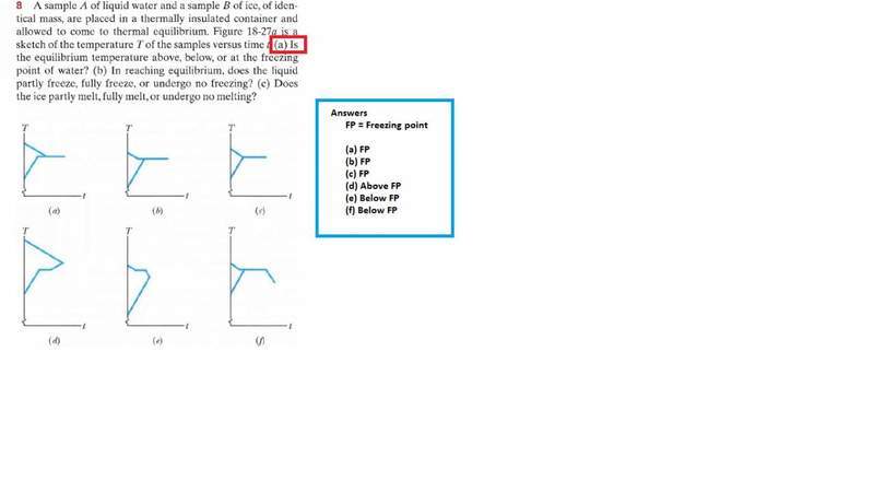

Evaluating Temperature v time graph
Miike012
1,009
Can someone verify if the answers to part a of the question are correct?
Question and answers are in doc
(a) - (e) appear correct. (f) puzzles me.
