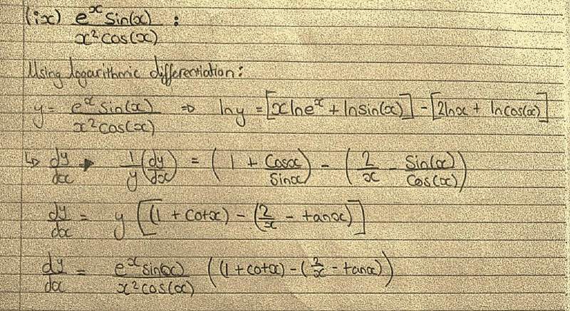

Sorry, its the following:
[(e^x)*sin(x)]/[(x^2)*cos(x)]
Please show us the work that you did.
Here is my working out so far, not sure if its correct though
I see one mistake, right when you took the natural log of both sides ln(ex) = x, not xln(ex) as you have. The work below that is correct, though, so you must have intuitively used the correct value. Your answer looks fine.
One way to check your work is to use the quotient rule to see if you get the same result.
