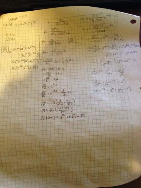

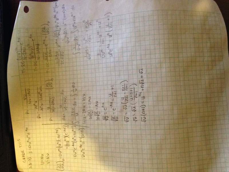

A system obeys the equations:
P=-(NU)/(NV-2AVU)
and
T=2CU1/2V1/2eAU/N/(N-2AU)
Find the fundamental equation
Hint: to integrate let s=Dunvme-Au
Where D, n, m are constants to be determined.
Aside from the given ones,
V=Nv
U=Nu
du/ds=T
du/dv=-P
I attached a picture of my work. I must have made a small mistake somewhere because I feel like I am very close to the answer.
Here is the picture rotated.
