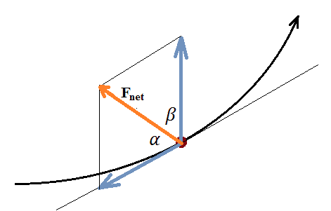

Look at the two forces acting on the particle and the net force produced by these two forces. See the attached figure. Let ##\small \alpha## and ##\small \beta## be the angles between the net force and the tangential and y directions, respectively. From the fact that the two individual forces are equal in magnitude, what can you conclude about ##\small \alpha## and ##\small \beta##?
α=β

If you look at the figure in post #6, you can see that the net force (red vector) projected onto the tangent line is in the direction to slow the particle down. But the net force has a positive y-component. So, v is decreasing while vy is increasing. So, you need to write
dv/dt = -dvy/dt.
Or
d(v+vy)/dt = 0.
So, you have a quantity whose time derivative is zero. What can you conclude about that quantity?

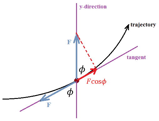

##\large \frac{dv}{dt}## is the tangential acceleration. So, ##\large \frac{dv}{dt} = \frac{F_{t}}{m}## where ##F_t## is the net tangential force acting on the particle.
You can get the net tangential force from the diagram: ##F_{t} = F\cos \phi - F = -qE(1-\cos\phi)##

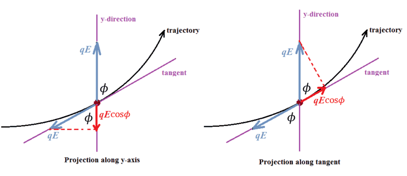

From Newton's second law applied to the tangential direction, the projection of the net force on the tangent line is ##F_t = ma_t## where ##a_t## is the tangential component of acceleration.
You can show that ##a_t = \large \frac{dv}{dt}##, where ##\small v## is the speed of the particle.
One way to see that ##a_t = \large \frac{dv}{dt}##, is to note that the velocity vector may be written ##\vec{v} = v \; \hat{e_t}##, where ##\hat{e_t}## is a unit vector tangent to the trajectory. So, the acceleration vector is $$\vec{a} = \frac{d\vec{v}}{dt} = \frac{d(v\hat{e_t})}{dt}= \frac{dv}{dt}\hat{e_t} + v\frac{d\hat{e_t}}{dt}$$
But ##\large \frac{d\hat{e_t}}{dt}## is either zero or points in a direction perpendicular to ##\hat{e_t}##. So, the first term on the right hand side of the equation above must be the tangential component of acceleration.
So, ##a_t = \frac{dv}{dt}##
Then the projection of the net force on the tangent line is ##F_t = ma_t = m\frac{dv}{dt}##.

The starting premise was that the net force was a resultant of two forces of equal magnitude . Force in y-direction = Force along the tangent =qE .From this we got ##\small \alpha = \small \beta## .Now when we project the net force along the tangent and along the y-axis ,we should get back the two original components of net force . In y-direction it is alright to say that the projection is qE .
But the projection of the net force along the tangent should also be qE and not dv/dt ?
Because dv/dt ≠ qE but is equal to qEcosθ – qE .
This is the issue I am having when you equate ## | \dfrac{dv}{dt} | = | \dfrac{dv_y}{dt} | ## .Because ## | \dfrac{dv}{dt} | ## is not the projection on the tangent .
Why this contradiction ? I guess I am not seeing something very obvious .
From the diagrams you should be able to see that the net force in the y-direction and the net force in the tangent direction have the same magnitude: ##qE(1-\cos\phi)##.

It looks like you might be forgetting the red vectors in the diagrams when thinking about the net force in the y or tangent direction.
